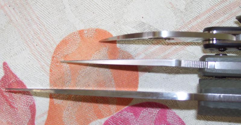

Part of the allure of the Balance for me now is that although small it is incredibly tough. An FRN version would have a different character that would most likely be quite nice. :) The CF version is built like a tank :D
Compared tang thickness between Balance, Urban, and SuperBlue mule. The Mule and the Urban are about even at close to 3 mm (0.115"). The Balance was only about 1/32"(0.015") thinner.
With a screaming sharp 40 deg edge I am very glad I plunked down what I did to buy it ;)
