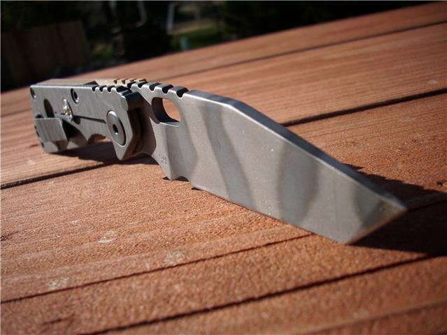

SnG's have a frame lock like this...Alot of spyderco's have liner locks that have a solid frame outside of the liner that dont have any sort of slit in them.

Yes, as I noted, the line is very blurry, not like ten years ago when the locking liner of most liner lock knives was about the thickness of CD.unit wrote:I'm interested in what you are saying, but finding difficulty understanding.
Can you provide examples (either photos or model names) of knives that
1. have this relief cut in the lockbar to allow it to flex
2. Do not have the relief you refer to.
I agree that some "liner locks" such as the Gayle Bradley are basically a frame lock with a decorative cover from my POV, but I think you are using a slightly different rationale.
This photo shows the relief cut, marked by the yellow arrow, in the Sage II's lockbar...
[CENTER]
[/CENTER]Some framelocks, like the Volpe and those made by Chris Reeve, have the relief cut on the outside surface of the frame.
I don't have a shot handy of the CF Walker Lock Sage from that angle, but it would be an example of a knife that does not have that relief cut.
