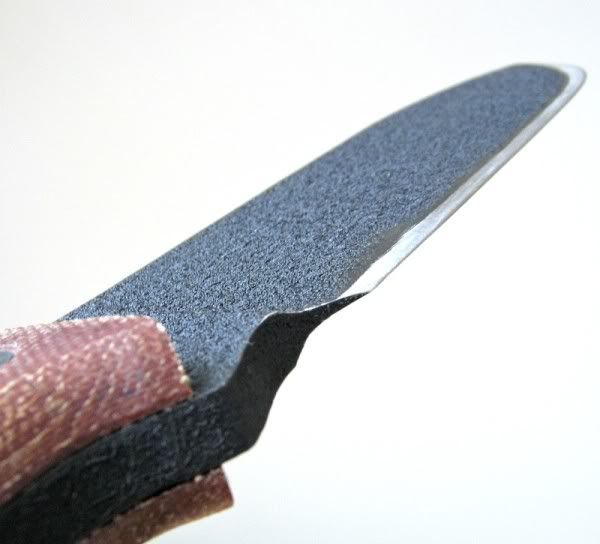

Sorry to keep posting in a thread I started (bad etty-kett?) but I found this post from Joe Talmadge over at BF. Given his authority, I thought I'd quote him here: “I make heavy use of 15-degree bevels for my folders and performance-oriented fixed blades. Often, I'll take a few light swipes on the 20-degree bevels to remove the burr, and sometimes I'll take a few more swipes when I want the edge just a touch thicker. But generally speaking, I expect a knife to take reasonably hard use at 15-degrees, and if it chips, I'd rather replace the knife than compromise my performance standards by changing the edge bevels.”
(That edge looks good to me, too, Huugh)
