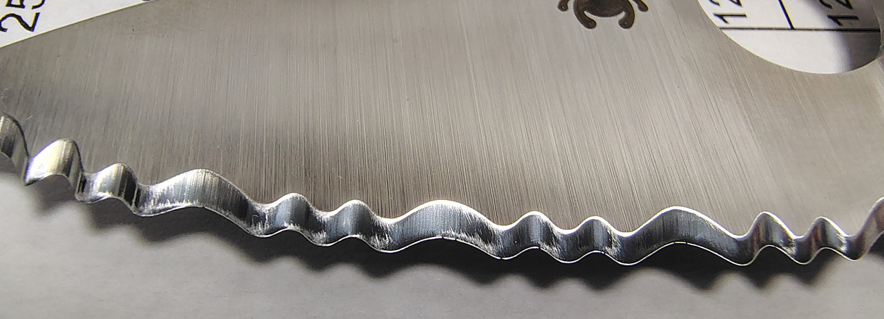

This is a photo of Chap's edge after a little sharpmaking (grey rods) at 30°
It seems that the chips are vanishing with this kind of sharpening, surely I need to go on.
Maybe 30° are right because I see both the "edges of the edge" are worked...but I'm not sure

Looks like you're on the right track and the 30° slots are getting the job done.

With this knife in particular you have a choice of which angle slot you want to use, because the angle of the serrations is lower than both, which was why I suggested starting with the 30 degree slots because you're actually making the edge thicker and more durable than it was from the factory and if you still get chipping then you can go a step further and sharpen on the 40 slots. On other knives you may not have a choice but to start on the 40 slots because the serrations are ground steeper than 15 degrees but less than 20 degrees. You can reprofile the entire serration grind by going to the 30 slots but it's time consuming and you really need CBN or diamond rods to do it right.
I have the CBN...do you suggest me to go on reprofiling? Maybe this way I strengthen my edge, that chipped so easily.

They'll speed up the process, just use a very gentle touch, not much pressure. Then move to the brown rods.

Got it! So I'm going with CBN.
Only question is: When I will know to stop CBN and go on with brown ones?

Not to sound sarcastic but when you don't see chips anymore :winking-tongue
Keep an eye on the edge as you go and take it slow, and don't he afraid to color the bevel with a Sharpie any time you want to see progress a little better.

When the scratch pattern from the CBN rods covers all the scallops from the shoulder down to the edge, then it’s a good time to switch to the brown rods to refine that scratch pattern.

Yes, I see: all the shoulder go down with CBN and then brown to refine :smiling-cheeks Thanks!

I can get my SE folders pretty sharp using the Sharpmaker, but never checked how sharp compared to factory SE edges.
Generally, since you have sharpened your Salt 2 a lot and by that it might have become thicker behind the edge already, it might be a good idea to fully reprofile it on the 30 degree setting?(You´d want diamond or CBN rods for that though)
Thanks for the link. Had seen the thread before but took the time today to read through the entire thing. I used the diamond rods at 30 but didn't fully reprofile as there was still some sharpie remaining in the small scallops, but I think it still helped to knock down the shoulders as mentioned in the sharpening thread. Then finished with the white rods at 40 but modified my technique based on the tips in the thread while checking for the burr with a flashlight. It cuts receipt paper now so pretty satisfied! Pic for the thread:
That looks good. By stopping when you did you now have a 15 degree bevel with a 20 degree microbevel in the scallops. You can always go back and complete the reprofile if you become interested in knowing how it’ll perform with 15 degrees to the very edge. Hint: better.
