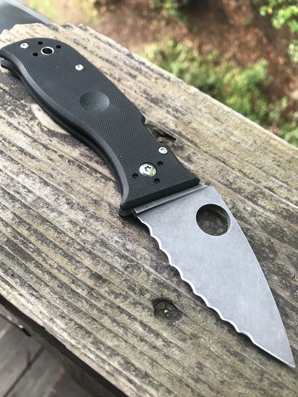

Modded a lil temp 3 the other day, thought you serration afi people would like to see
Did you grind these free-hand? Assuming with a Dremel? They look good!

Drubieg
Posts: 229
Joined: Thu Mar 03, 2022 12:43 am
Re: SE performance is more than simply teeth vs no teeth.
#904
Post by Drubieg »
PeaceInOurTime wrote:
Wed Mar 05, 2025 9:39 am
Drubieg wrote:
Thu Feb 27, 2025 7:39 am
Yessir freehand. I spaced them about 1/4” apart to land the middle of the dremel wheel on. Thanks!

Hi,
I'm about to buy a Chaparral to EDC, I love this little guy...so I'm trying to decide if Plain or SE.
I've only a few serrated one from old time, like my first Syderco, the Cricket :-) but I seldom carrie it, don't know why BTW.
I know well that you guys here are very biased :-))) but you really think it could be better than the plain one?
And do you think that the Sharpmaker is right for sharpening its serrated edge?
Thanks

@Jumpin’Spyder : SE Chaparral is incredible! Scary sharp right out of the box, and with a touch up on the Sharpmaker mine will split a hair. Build quality is excellent. Very highly recommended, especially in SE!! All SE knives should be like this one!
-Jeff-
Thanks
Sharpmaker is absolutely the right tool for the job, and I think the SE Chaparral is a perfect knife to start with if you're not very experienced with sharpening serrations. Whether you like it or not I can't say, but I feel confident saying that it's one of the best SE knives to start with.
