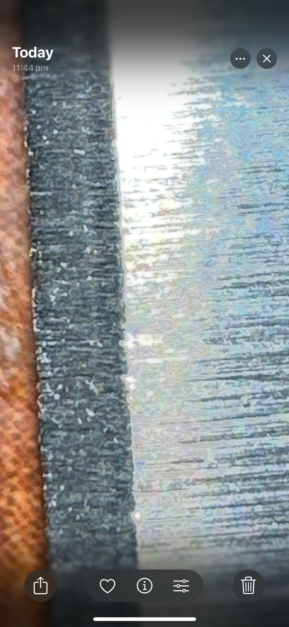

A knife I just CAN’T get sharp…
This is probably best suited for this place instead of its own thread. I have two specimens of zdp189…an Endura and a Stretch 2. What’s the difference besides the obvious? For over a year, I’ve been trying to get the Stretch up to my personal standards of sharpness and it just refuses to “take”. The Endura? No problem…after a single sharpening session, I had it exactly where I wanted it. But the Stretch, to this day, eludes me. I’ve tried different progressions. By now I’ve removed enough metal that I’m positive there’s no “burnt edge” factory nonsense that I’m dealing with. I can get it to cut paper but no further. I don’t think it’s entirely my doing either…I have maxamet, 15v and rex 121 knives all beyond the point of shaving. Even another zdp model in the Endura…that one will whittle hair for petesake. I desperately want to get the Stretch up to snuff because it’s right in the wheelhouse of stuff I love to carry…

What does the edge look like under 10x magnification?Manifestgtr wrote: ↑Sun Nov 03, 2024 2:11 pmI’ve been trying to get the Stretch up to my personal standards of sharpness and it just refuses to “take”

One of these is the endura which gave me no issues whatsoever…the other is the stretch. I think it’s probably pretty obviously which is which lolRustyIron wrote: ↑Sun Nov 03, 2024 3:38 pmWhat does the edge look like under 10x magnification?Manifestgtr wrote: ↑Sun Nov 03, 2024 2:11 pmI’ve been trying to get the Stretch up to my personal standards of sharpness and it just refuses to “take”

Manifestgtr wrote: ↑Mon Nov 04, 2024 9:49 pmOne of these is the endura which gave me no issues whatsoever…the other is the stretch. I think it’s probably pretty obviously which is which lol
Yup... like so many of life's challenges, dull blades can be figured out by taking the time to examine them closely.
Re: Community Sharpening Journal, Part 2
Wow - What a marked difference.Manifestgtr wrote: ↑Mon Nov 04, 2024 9:49 pmOne of these is the endura which gave me no issues whatsoever…the other is the stretch. I think it’s probably pretty obviously which is which lolRustyIron wrote: ↑Sun Nov 03, 2024 3:38 pmWhat does the edge look like under 10x magnification?Manifestgtr wrote: ↑Sun Nov 03, 2024 2:11 pmI’ve been trying to get the Stretch up to my personal standards of sharpness and it just refuses to “take”
Based off my own very limited knowledge, I'd say cut that apex-ish off, and make a new one. Do the whole - wash, rinse, repeat - thing until you stop getting raggedy, crumbly, sticky/gummy burr vestige(s) edges.
Off the top of my head, I've had three Spyderco knives that had edges that just wouldn't "take", then after multiple sharpenings they did finally take (and hold) an edge. Two of those three took more than six new edges before the edge finally "took".
I always question my own sharpening skill/ability when I first notice it (an edge not "taking") - defaulting to some sort of error on my part. As you have done, a good look under magnification usually provides good data with which to go from.
i.e. For me, if under magnification I verify zero burr remaining, and the edge crumbles and/or rolls, then I'll got a little thicker/more obtuse and try again. If going thicker/more obtuse doesn't help, I'll just apex over and over until the edge stops failing.

Which is exactly what happened to me here. The stretch was the first ZDP specimen I picked up so when it was totally fubar after the initial sharpening, I immediately began reevaluating my progression, technique, everything…”does my sharpening style just not work when there’s an overwhelming abundance of chromium carbide?”u.w. wrote: ↑Tue Nov 05, 2024 6:28 amManifestgtr wrote: ↑Mon Nov 04, 2024 9:49 pmOne of these is the endura which gave me no issues whatsoever…the other is the stretch. I think it’s probably pretty obviously which is which lolRustyIron wrote: ↑Sun Nov 03, 2024 3:38 pmWhat does the edge look like under 10x magnification?Manifestgtr wrote: ↑Sun Nov 03, 2024 2:11 pmI’ve been trying to get the Stretch up to my personal standards of sharpness and it just refuses to “take”
Then the endura was no problem, which at least hinted that it wasn’t ENTIRELY my own doing.
