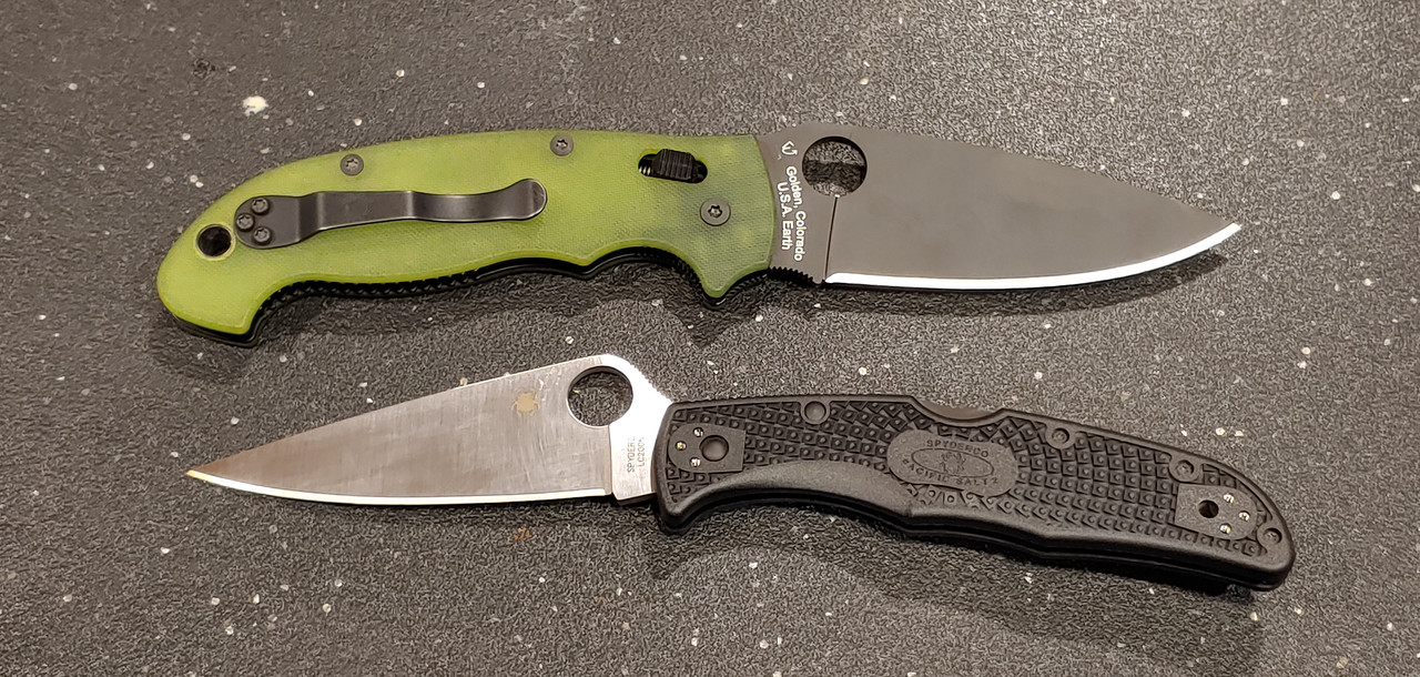

That's semi-typical. S30V varies in sharpening response. Some turn out well and some seem like they have very little apex stability, as if the apex just crumbles once it reaches a certain width/keenness. Any skilled sharpener can make s30v work but it's not what I'd call a "sharpener's steel". BD1 gets extremely sharp easily and so does VG-10. I think whatever edge you like on BD1 you'll also like on VG-10.Vivi wrote: ↑Sun Oct 20, 2019 8:27 pmStrange stuff.
When I sharpen my S30V Manix XL on my diamond sharpmaker rods, I find it difficult to get acleanly shaving edge.
I tried out my BD1 Ronin 2 and managed to get it hair popping sharp off the diamond rods.
Not sure why the Ronin seems to get so much sharper off the same stones but it's a really nice feeling edge. Very toothy but push cuts through things pretty well.
I've been debating what sort of finish I'm going to give my VG10 Police 4. Might try out the diamond edge and see if it responds as well as BD1.

I assume the manix xl has been sharpened way past the factory apex, yes?Vivi wrote: ↑Sun Oct 20, 2019 8:27 pmStrange stuff.
If so, do you have a coarse diamond plate you can sharpen it on to compare to the sharpmaker rods?
I just sharpened a sage1 on a fairly new eze lap coarse plate, it produced a nice clean shaving edge. I don't have sharpmaker rods to compare.

This Manix XL easily gets hair popping sharp on my extra coarse dmt.jpm2 wrote: ↑Mon Oct 21, 2019 9:16 amI assume the manix xl has been sharpened way past the factory apex, yes?Vivi wrote: ↑Sun Oct 20, 2019 8:27 pmStrange stuff.

bd1 sharpens more easily for me, but I've always been able to get the two steels equally sharp using the medium or fine stones from spyderco.
this is the first time I've seen the steels reach noticeably different levels of sharpness off the same grit. It's weird. I can get the Manix XL very sharp on the diamond rods, but the Ronin is on a different level.
By the way I'm ordering a fresh DMT plate today. I'm debating between the 8" and 11" in extra coarse. Continuous surface this time so my tips don't get caught up in those silly holes. Thought about getting an XX Coarse to replace the one I loaned out, but I like the X Coarse for sharpening a lot more than the XX.

That's strange indeed. How well broken in are the diamond sharpmaker rods?Vivi wrote: ↑Mon Oct 21, 2019 10:50 amThis Manix XL easily gets hair popping sharp on my extra coarse dmt.jpm2 wrote: ↑Mon Oct 21, 2019 9:16 amI assume the manix xl has been sharpened way past the factory apex, yes?Vivi wrote: ↑Sun Oct 20, 2019 8:27 pmStrange stuff.

All my diamond plates at home are continuous, the largest 6x2. My employer bought me this DMT in C/F, for use at work.
https://www.dmtonlinestore.com/10-DuoSh ... -P7C2.aspx
I like the size, but dislike the interrupted surface. It gets the job done, but awkward compared to my continuous plates.
It seems eze lap coarse is equivalent to dmt x-coarse.

I have a 6" x coarse and fine and they feel a little undersized for larger knives. Definitely getting continuous this time.jpm2 wrote: ↑Mon Oct 21, 2019 12:13 pmThat's strange indeed. How well broken in are the diamond sharpmaker rods?Vivi wrote: ↑Mon Oct 21, 2019 10:50 amThis Manix XL easily gets hair popping sharp on my extra coarse dmt.jpm2 wrote: ↑Mon Oct 21, 2019 9:16 amI assume the manix xl has been sharpened way past the factory apex, yes?Vivi wrote: ↑Sun Oct 20, 2019 8:27 pmStrange stuff.

I just compared my two current favorites. My M4 Manix sharpened to 200 or 300 grit then stropped with 40 micron diamond paste, vs a hair popping sharp FFG LC200N Pacific Salt 2 with a polished finish from the factory stropped on 1 micron diamond paste.
If I run my fingernail down the length of the edge of the Manix, it feels rough and gritty. If I do the same on the Pacific, it feels perfectly smooth.
Both showed equal shaving ability, easily popping hairs off my left forearm.
They both cut well, but they cut differently. The Pacific Salt will glide through materials on a push cut more easily, while the Manix will push through material more aggressively during a slicing motion.
