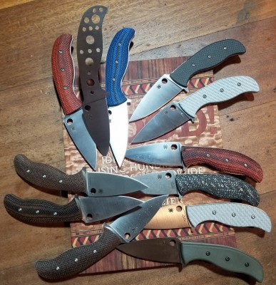

And Crux, I appreciate you showing your "herd" as a bit of an incentive. Various styles in there. And they all look to be attached with screws.
One sort simply uses flat scales and rounds the edges, which looks like something even I could do with my current skills. This is essentially what the Spyderco Junction is like.
The ones like the mule scales you can buy, maintain a constant thickness from one end to another, but are curved across their entire surface. They could even be part of a cylinder, I'm not sure -- but even this wouldn't be hard to do. I have some of those on hand to study carefully.
What a person really wants though is something with some palm swell -- I would have to experiment, but it is good to know that these simpler shapes are quite serviceable!

These are great -- thanks! Reminds me of the "suspended project" of getting this little bandsaw I bought at an estate sale on the air. That is what my life is all about these days, getting unfinished projects finished -- and it feels great!
I found BSI 30 minute epoxy at USA Knifemaker (as well as West System, but in larger quantities).
Then the decision arises of whether to include a lanyard tube or not.
