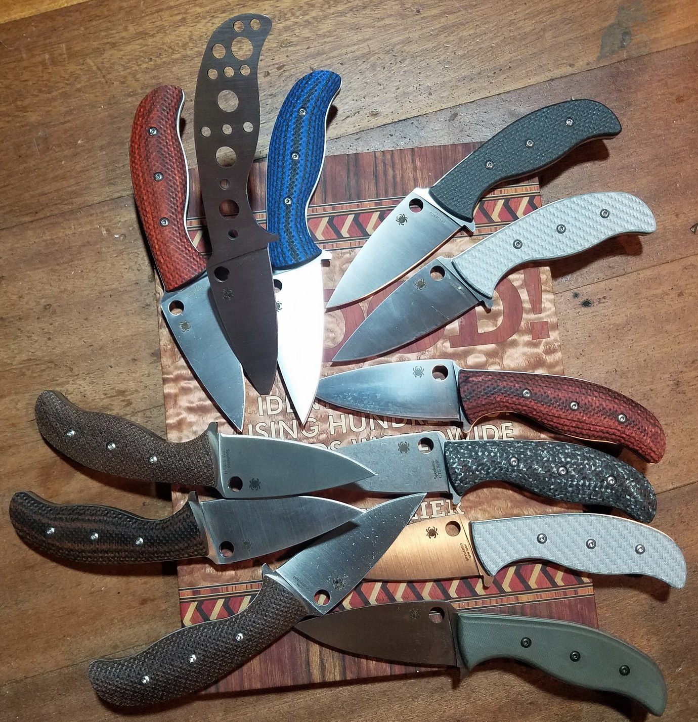

Mules during feeding time.

And Crux, I appreciate you showing your "herd" as a bit of an incentive. Various styles in there. And they all look to be attached with screws.
One sort simply uses flat scales and rounds the edges, which looks like something even I could do with my current skills. This is essentially what the Spyderco Junction is like.
The ones like the mule scales you can buy, maintain a constant thickness from one end to another, but are curved across their entire surface. They could even be part of a cylinder, I'm not sure -- but even this wouldn't be hard to do. I have some of those on hand to study carefully.
