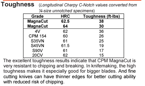

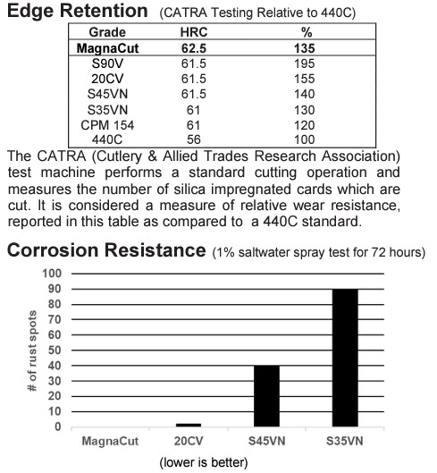

Have you guys seen CPM's datasheet? It's interesting. I'm curious what the HRC they are shooting for to obtain certain qualities. More overall toughness or more edge stability. Honestly, looking at the toughness chart, not sure you can go wrong either way.
chrome-extension://efaidnbmnnnibpcajpcglclefindmkaj/https://nsm-ny.com/wp-content/uploads/2 ... heet15.pdf

Re: Magnacut
Just a side note, but I was not aware that 20CV is that much better when it comes to the corrosion resistance as the S35VN and S45VN.
... I like weird
Re: Magnacut
Yeah 20CV and its equivalents have always ranked really high in corrosion resistance. Personally, I have never gotten any to stain to develop or any rust spots. One of the redeeming qualities I guess of those steels. Not the toughest, but not terrible either. Great wear resistance as well. Pretty good EDC steels unless you value toughness and edge stability more with the corrosion resistance trade off. That was until Magnacut at least.
