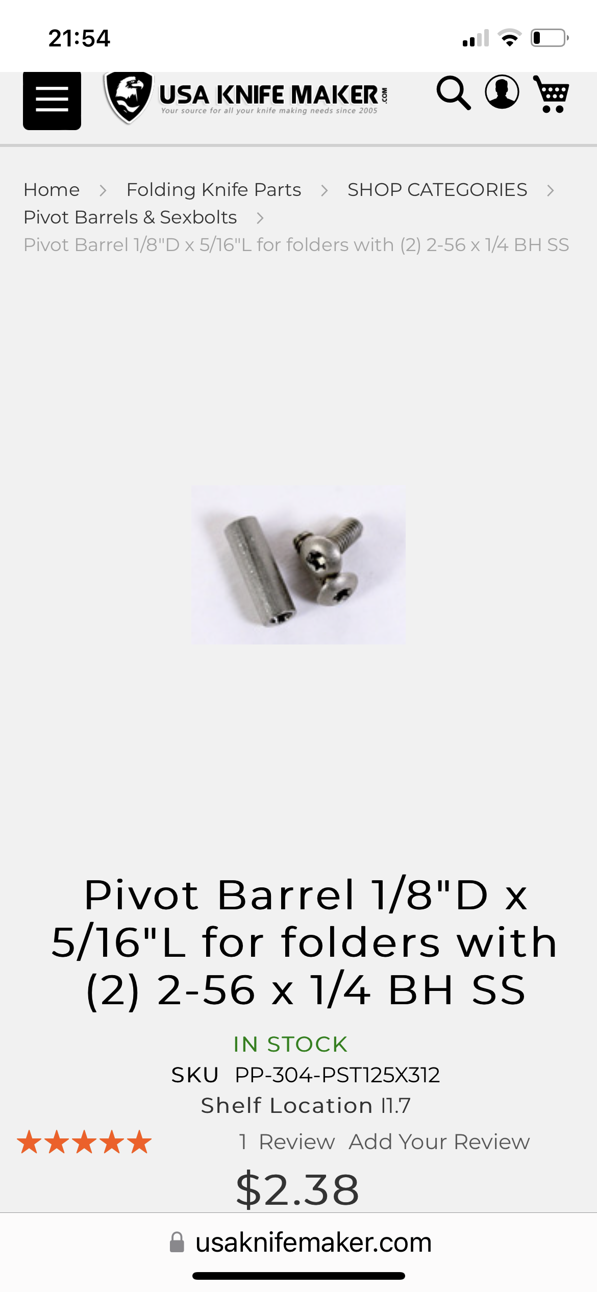

attila
Posts: 1859
Location: Maryland
Re: Manix2 lwt Still Pinned
#67
Post by attila »
Sun Nov 06, 2022 4:02 am
razorburn wrote:
Sun Nov 06, 2022 2:54 am
Still patiently waiting for that Manix2 LW Magnacut. Converted all three of these recently.
great job! that makes me want to convert mine, but i'm nervous about messing up a good knife.
I was nervous at first as well, but it’s not bad to do the conversion if you’re careful:
https://www.bladeforums.com/threads/man ... t-20547888
Keep in mind that I’m not the only one who posted how I did it. There are a couple of other tutorials on BF.
The hardware I used is this:
https://usaknifemaker.com/pivot-barrel- ... bh-ss.html
Since doing my conversion, I wanted less tall screw heads than the T8 clip screws I used, but I found that the 2-56x1/4” T6 screws were too long. I filed/sanded them down to something <3/16” to allow them to tighten properly. Now, the screw heads are much closer to flush with the FRCP, about how the original rivet heads were, but I now need 2 torx drivers for disassembly.
Want: SPY27, K490, Swick 5
