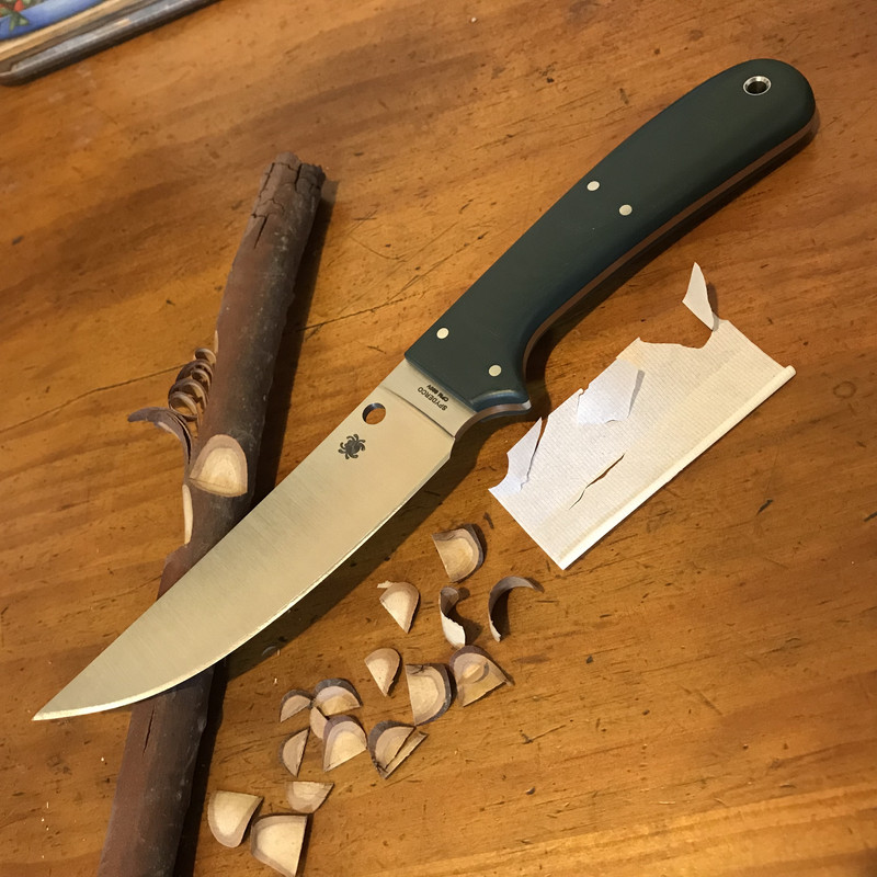

I like polished edges but today sharpened some Maxamet to a 150 grit finish off a Venev bonded diamond stone followed by 2 passes on bare basswood just to make sure I wasn't missing something. So far, for the things I usually cut, I still prefer a polished edge.
Probably won't be long before it looks like my PM2 again.

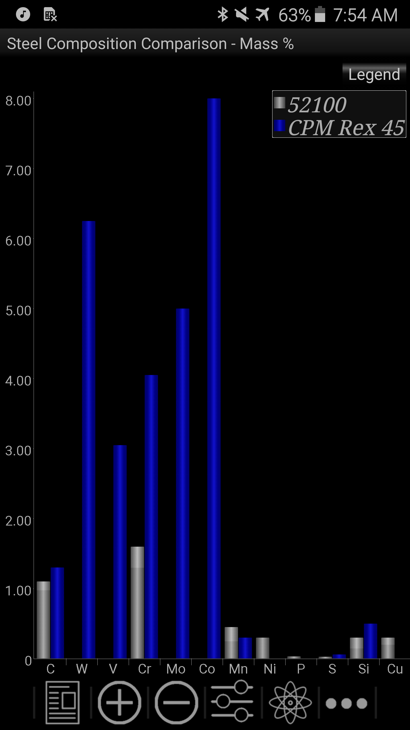

Nothing bad in taking Rex 45 to a fine edge, at the end of the day it has the same low carbide volume as 52100 (5-6%) while being significantly harder, so it's edge strength will be improved. Nothing wrong with doing it with Maxamet too, since it's matrix is also high hardness so unless your arm is an an industrial cutting machine, it won't really make a difference for you except slicing less aggressively depending the medium you're cutting. I use Rex 45 mirror polished with a finishing of 1.5 micron diamond emulsion on strop, and my maxamet is still having the factory edge but I'll give it a polished edge when it will need a proper sharpening. For now, the 1.5 micron strop seems to keep it hair whittling sharp.
Looking at the edge under magnification on the Maxamet Manix, it seems to be 15dps low grit edge with a higher angle microbevel (possibly 20dps) that's mirror polished. I'm very satisfied with its performance so far, so I'll keep it polished.
I'm now curious about the next 15v knife in the works and how that one will perform with a polished edge, but that will also depend on what hardness spyderco aims for, but I'll most likely find a middle ground (1000 grit + 1.5 micron strop sound attractive looking at it's steel composition).

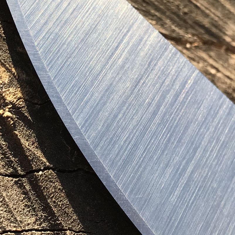

Hey Does, that’s a savage looking edge on the Military and it seems like you’re enjoying your new stones. I think it’ll be interesting to see how the thin edge holds up.
I like S90V and I’ve used it quite a bit, primarily in my Sprig which although not a fillet knife per se, does an excellent the job on fish I catch.
Anyhow, I don’t know the answer to your question but here’s a look at my coarsest finished blade.
This is my Southfork finished on a 220grit SiC stone and a half hearted strop with chrome oxide on stiff leather. No my sharpest knife but seriously aggressive.
This is as good a pic I could get of the edge.
Here’s another pic of the edge in a different light. :eek:
Push cuts hardwood surprisingly well. Grabs cigarette on contact and rough slices that too. :)
