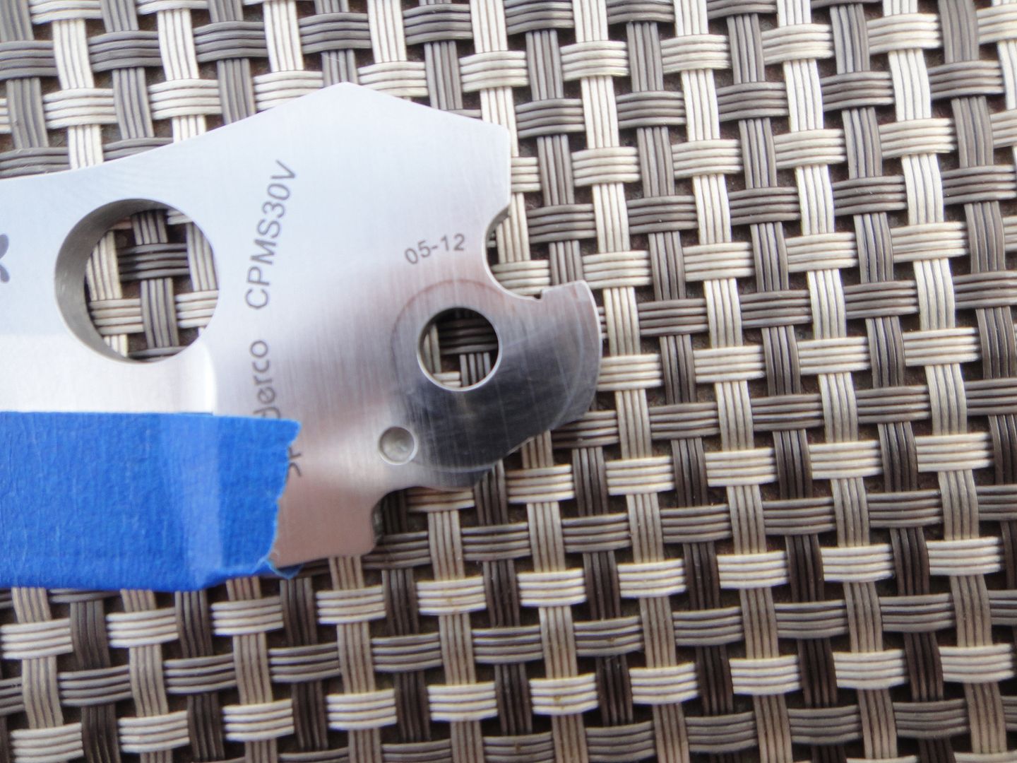

You keep saying it hit the "detent'...I'm not sure we're using the right terminology. The detent is a dimple drilled into the tang of the blade that you can't see without taking the knife apart, that a ball bearing embedded into the lock tab sits in when shut that keeps the knife from opening. The blade wouldn't hit that since it's part of the blade.
If you mean the blade hit the last pillar/standoff, which is the only thing close to the tip/pic that you posted, then I would seriously like to see the knife. I'm not calling you a liar, I'm just saying that it should be physically impossible given the design of the knife, and if it actually did happen then you should have an insane amount of blade play, probably in every direction, and the knife is defective and needs sent back to Spyderco for evaluation. Either the stop pin is somehow not in the right place (which would allow this to happen EVERY time you close the knife) or your last pillar is in the wrong place which would also allow this to happen every time you close the knife.

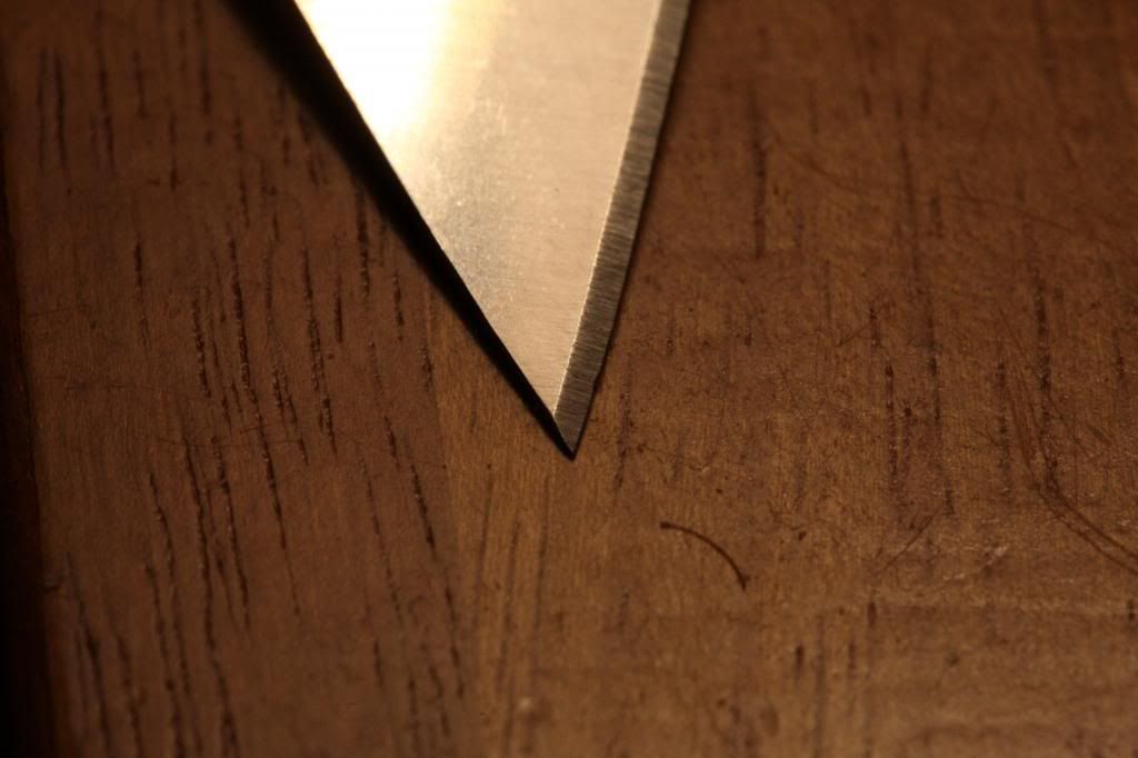

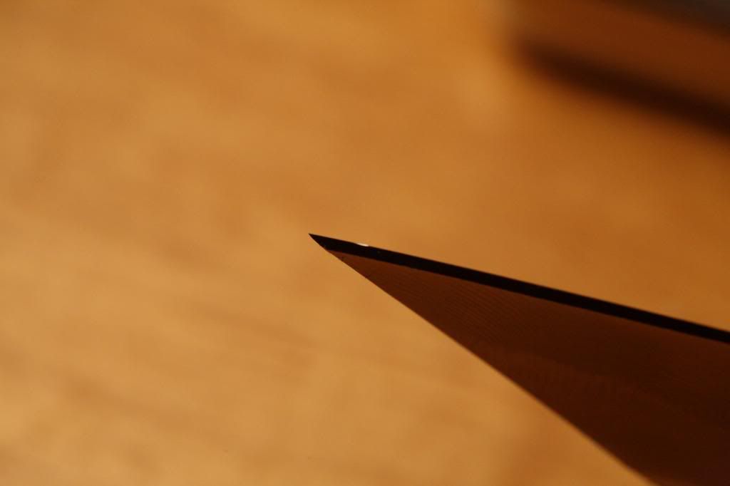

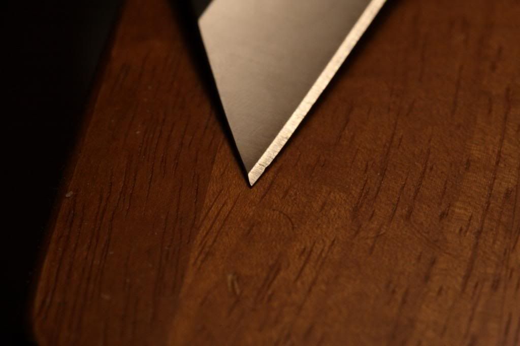

Yeah my bad. Not the detent. I'm still new and learning haha. The last pilar is what it hit. There is no blade play thankfully. I'm hesitant to close the knife with any kind of force as I'm afraid the damage it again. Once it's closed I've squeezed the blade and it doesn't move so I don't understand it either.
Maybe do me a favour and close your yo2 as hard as you can to see if it happens lol. Thanks for working through this with me though.

I don't have it at the moment, but here's a pic to show you what's happening inside the knife, and why this can't be possible without some kind of major malfunction.
In this pic, on the bottom just behind the edge there is a little dip in the tang of the blade. That dip hits against the under side of the stop pin that the blade hits when open. So, unless the blade can somehow travel past the stop pin when closed, there's no way the blade can move that far. It's a physical impossibility lol.
Also in that pic, you can see the little dimple that the detent sits in to keep the blade closed. Either way, if it did happen, send it back to Spyderco because something major is wrong. They need to see this sort of stuff to prevent it from happening in the future.

I've tried closing it with a moderate amount of force and its not damaging the blade at all. So that is good. However, if I squeeze it while closed towards the pillar I am able to get the blade to move down enough that it looks like it would touch the pillar. I've already disassembled the knife so the warranty is void. She's my problem now. I want to be clear that I love this knife and am very happy with my purchase. The damage to the blade was an error on my part and after all of this I'm pretty certain that the knife is in perfect working order. If anyone wants to try and squeeze their blade while shut and let me know if they can get it any closer to the pillar it would be appreciated.

Cobra, hate to say this but you're not crazy. I was slightly disappointed when I opened my Yo2 from Howes last week or week before and found the exact same thing you're describing. This is the untouched factory edge. However, after opening and closing it repeatedly, I was satisfied that it wouldn't make contact again during normal use.
I am able to squeeze the blade enough that it will eventually come into contact with the pillar; however, this is with both thumbs on the spine of the blade pushing down. It would take quite a close to do that. I'm wondering if a few of these got dropped after assembly?

Sweet. I'm not crazy lol. A quick sharpening on your yo2 should fix it up nice. Thanks for posting!

It's off getting reground. I wonder if there are enough variances in the actual grind of the edge that some blades are wider from spine to edge, and that would allow some level of contact? I know my Yo 2 in particular, the grind of the edge was lower than the flat part of the tang just behind the edge. I guess it might be possible that some are even lower? When I get mine back I'm planning on taking it apart again to take more pics of the scale mods I've done to it. When I have it apart I'll take pics of the blade and see how close it can get to that pin.Clip wrote:David, try your Yo2. The curved spine of the blade where the thumb naturally falls is thick enough and at the proper angle to really apply some force. Like I said, this isn't an activity I usually perform when carrying my knives so there's really no need to try and force the blade down more than it wants to travel, but I'll try to take a picture or short clip of it moving closer to the spacer.
