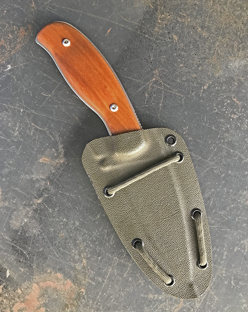

What follows are some notes on my (this time, successful!) attempt to make a mule sheath. There is definitely a learning curve here! First below, my blueprint. It is sized for the commonly available 1-1/8" web belts. The standoff of .33" from knife to center of eyelet turns out to be critical (for my setup), due to the anvil of my eyelet setter not allowing anything closer than that. The distance from the guard to the nearest "guard eyelet" (currently set at .40") is also critical...slightly higher and the fit is tighter; slightly lower and the fit looser...this is what works for me, but you can adjust to suit. But remember you'd have to move all four of the eyelets that make up the "belt area" up and down in unison, in order to keep the sheath aligned straight up and down and still fitting a 1-1/8" belt.

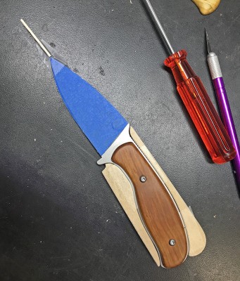

Posts: 5982
Re: Making a Kydex Sheath (step-by-step)

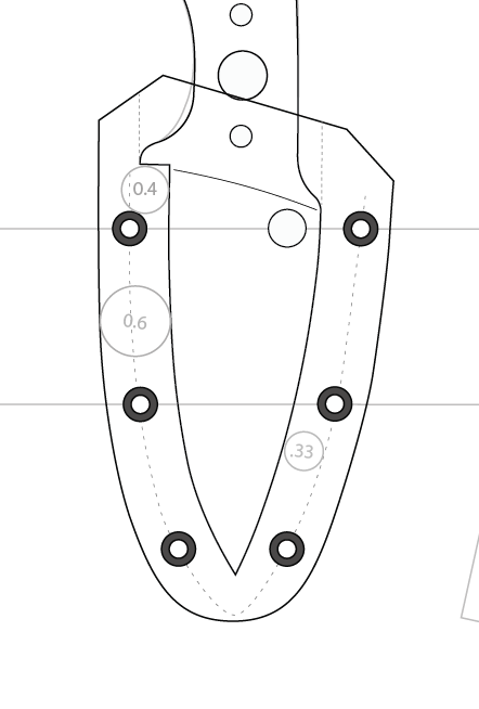

#45
There's a bit of setup to make a sheath like the one shown here. I wanted: (1) a larger opening, thus a larger "target," for the entry of the blade. I don't like threading the blade into a narrow slot, and for narrow-slot sheaths, it's common to catch the tip upon insertion. That's what the spacer sticks are doing above and below the handle...keeping the insertion opening wide. But I also wanted (2) a "catch" behind the guard/kick to help lock the knife into place, despite the wider opening. That's why you see a notch in the spacer behind the guard/kick. I considered another catch on the spine, but opted to try it without. On my next sheath, I may try adding a catch there, too.
Other items you may notice: (3) the toothpick at the tip, to create a drain hole; and (4) a dowel plug in the spydie-hole! Yes! A previous sheath did not plug the spydie-hole, and while it helped retention due to the concave divot it created, it scraped the steel blade rather badly across the spyder logo. So for this sheath, the hole got plugged.

Below, you can see the wider opening I was going for.
You may also notice an extra eyelet you didn't see in the blueprint. On this sheath I'd set the below-the-guard eyelet at .50" and while it was fine, it wasn't quite as tight as I wanted (which is why the blueprint now reads .40"). To compensate, I put an extra, higher outlet to the spine side, which tightened it up to my preference. (I could not put another eyelet on the blade side as the next space higher allowing for an eyelet was too close to the guard and caused too tight of a fit. But fortunately you can adjust snugness of fit by tightening either front or back of the sheath.)
Another big learning moment...bevel the edges of the insertion area BEFORE you eyelet the two pieces together. You can't see it too well in the photo but the edge around the insertion area is beveled from inside to outside at about 45 degrees. It's MUCH easier to do this beveling before eyeletting, and also much easier to clean out the sheath from the resulting dust. (As a footnote, I left the two bottom eyelets off until I was done, so that I could easily run a strong stream of water through the sheath to clean it out. For reasons unknown to me, Kydex dust appears to scratch blades.)

The finished sheath with paracord used for belt attachment. It's not a sophisticated attachment method, but it is good for a backpacker because it's (1) lightweight (2) holds snug to the body and (3) allows a bit of emergency cord if needed, for some other use. It's slim enough that the sheath and knife can be slipped into the sidepockets of a backpack, if belt wear is inconvenient. Sheath weight is 1.0 oz, bringing the knife + sheath weight up to 4.0 oz with the swell-center cherrywood scales (which are optional but comfy).

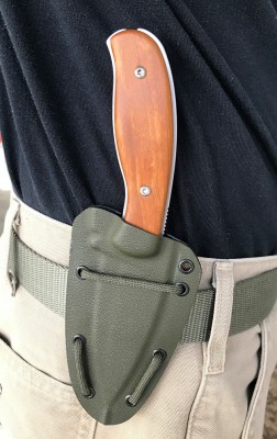

Posts: 5982
#48
A snug carry where the knife "snaps" in and out of its sheath. There are actually two retention points...the aforementioned catch, and also the "hook" that's provided by the forward part of the cherrywood scales. So it's a double-snap system.
