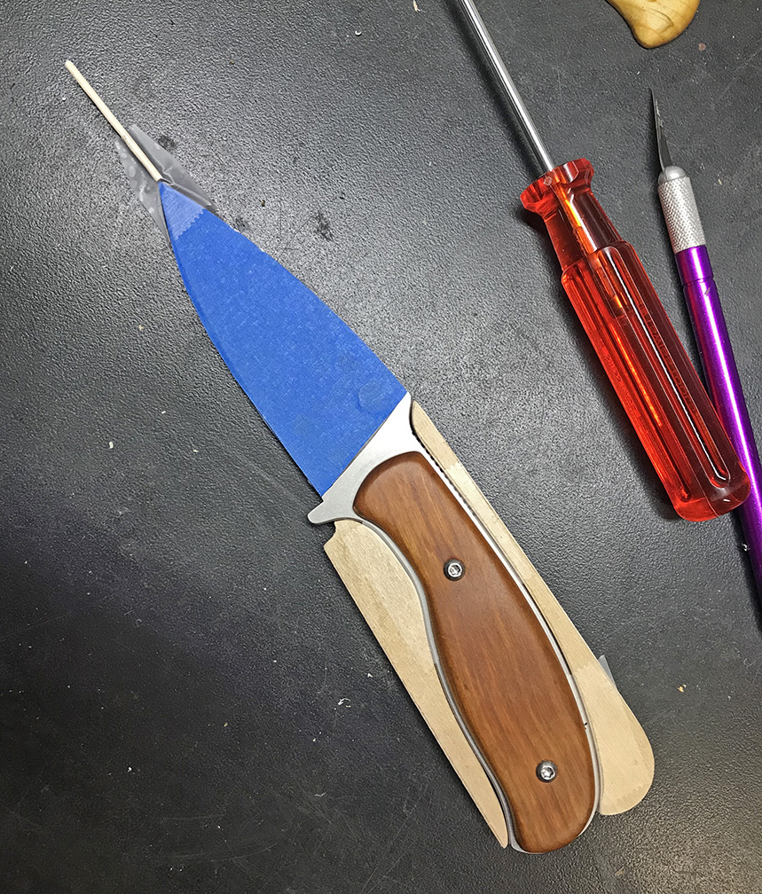

What follows are some notes on my (this time, successful!) attempt to make a mule sheath. There is definitely a learning curve here! First below, my blueprint. It is sized for the commonly available 1-1/8" web belts. The standoff of .33" from knife to center of eyelet turns out to be critical (for my setup), due to the anvil of my eyelet setter not allowing anything closer than that. The distance from the guard to the nearest "guard eyelet" (currently set at .40") is also critical...slightly higher and the fit is tighter; slightly lower and the fit looser...this is what works for me, but you can adjust to suit. But remember you'd have to move all four of the eyelets that make up the "belt area" up and down in unison, in order to keep the sheath aligned straight up and down and still fitting a 1-1/8" belt.
Re: Making a Kydex Sheath (step-by-step)
There's a bit of setup to make a sheath like the one shown here. I wanted: (1) a larger opening, thus a larger "target," for the entry of the blade. I don't like threading the blade into a narrow slot, and for narrow-slot sheaths, it's common to catch the tip upon insertion. That's what the spacer sticks are doing above and below the handle...keeping the insertion opening wide. But I also wanted (2) a "catch" behind the guard/kick to help lock the knife into place, despite the wider opening. That's why you see a notch in the spacer behind the guard/kick. I considered another catch on the spine, but opted to try it without. On my next sheath, I may try adding a catch there, too.
Other items you may notice: (3) the toothpick at the tip, to create a drain hole; and (4) a dowel plug in the spydie-hole! Yes! A previous sheath did not plug the spydie-hole, and while it helped retention due to the concave divot it created, it scraped the steel blade rather badly across the spyder logo. So for this sheath, the hole got plugged.
So, yes, a rather complex setup here. Not as carefree as some other designs.

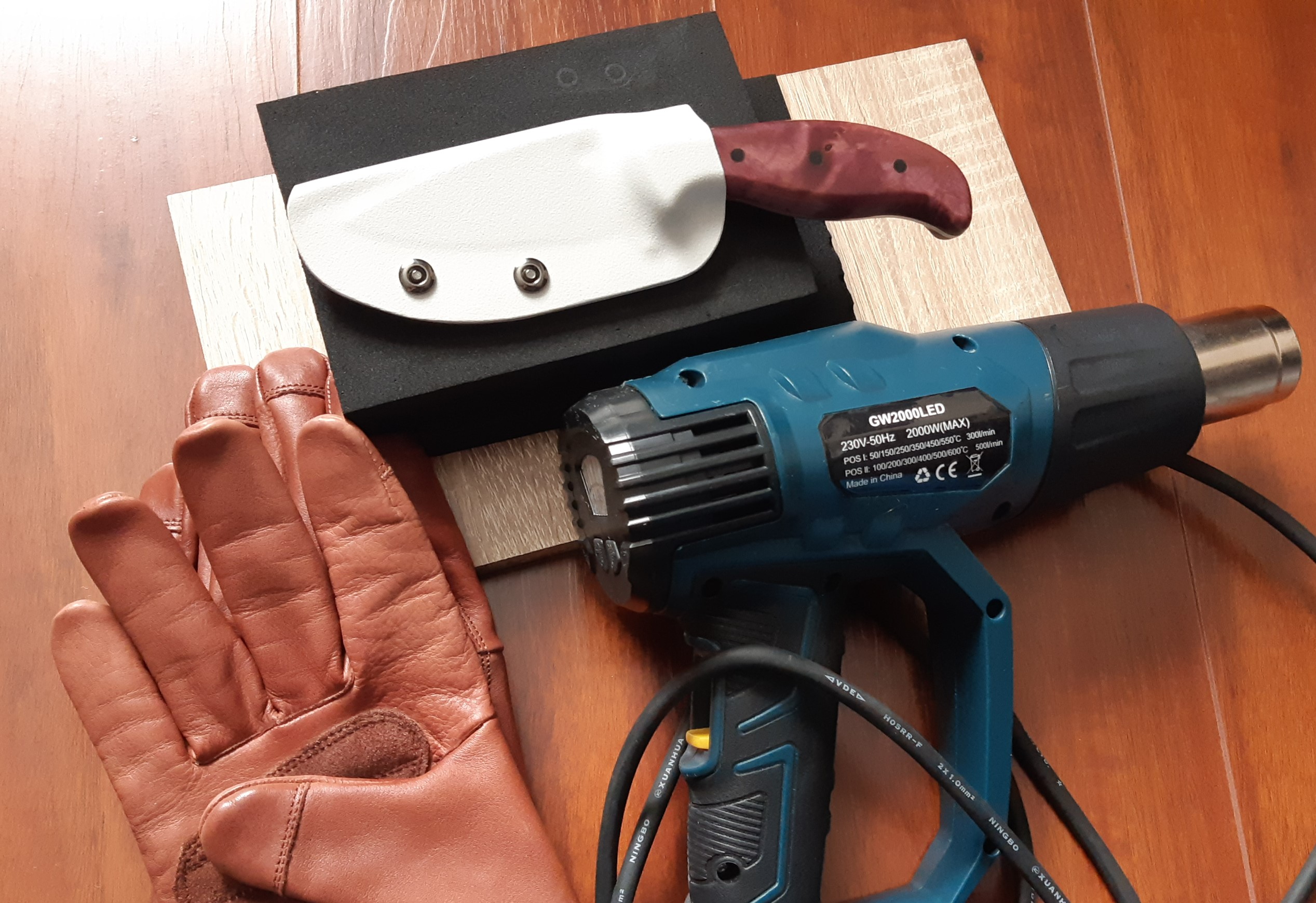

Well, here is my very minimalistic kydex sheath set-up:
heating gun, leather gloves, two foam blocks, one wood panel (yes, I am actually standing on it for 5 to 10 minutes
Well done, sir! Looking good!
(Does you wife know you've borrowed her hair dryer?
I love this! ^^ Motivation and determination are more important than any tools. Well done sir!
