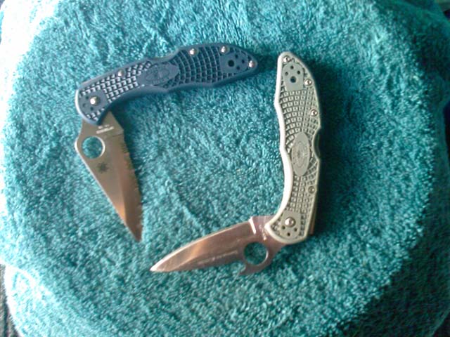

Thanks Mr Blonde & others, just used this thread to build my ultimate Delica, a G10 Wave combo:

Booya wrote:Thanks Mr Blonde & others, just used this thread to build my ultimate Delica, a G10 Wave combo:
Chris
Very nice.
