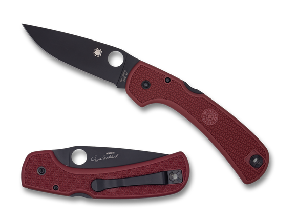

If it still is:
You folks who think about getting and really plan on carrying and using one... don't hesitate!! It's a great knife, and great EDC user that carries extremely well (slim, flat and light)
And it's 4Vs edge retention is (even) better than I would have thought.

Would have loved to read your impressions on the Goddard..
I guess coated blade, linerless construction,pretty much no thumb ramp, long grip area should be things you like.
Don't know if also the very thin handle, less "piercy" (compared to the Chief) tip and the "choke up area" which I like a lot but is not an actual choil and puts the hand pretty far from the edge when gripped behind that area.
