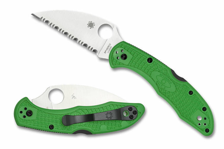

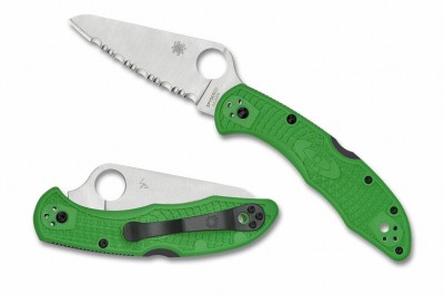

My next knife will be a Salt 2 serrated, I just can’t decide if I want the normal blade shape or the Wharncliffe.
Big fan of wharncliffes in general but not sure if it’s the ideal shape for a serrated edge.
Thoughts? Which would you get?

I would say a wharnie actually is about the ideal shape for serrations, because serrations are really good at pull cuts and the more leverage you can get in a cut from the shape or angle of the blade the more powerful it cuts. But, I'd also argue that the Delica/Salt is IMO a sort of modified wharncliffe/sheepsfoot anyway, it has very little belly and the tip to me is more of a sheepsfoot than anything else. You'll have a bit easier time cutting against a flat surface with the standard blade shape but I bet the two are similar in most cuts until you really start focusing the work on the tip and that's where the wharnie may have either an advantage or a disadvantage depending on the situation (cutting board for example).
Is this your first serrated knife? If you already like wharnies then you know what to expect from using the blade shape so that shouldn't be much of a surprise. I think overall the biggest difference here is that the wharnie has a sharper tip, and if I were buying the standard blade shape I'd most likely reprofile the spine down to a sharper point and I think I'd go that route because I like the slight belly for that small bit of extra versatility while still being a good pull cutter.
Thanks David, I appreciate such a well written response. That gives me a lot to think about.
This is my first full serrated pocket knife but I’ve carried and sworn by partially-serrated knifes most of my adult life.
I should’ve stated in my initial post, but this knife will mainly be my kayaking/fishing/around the water knife, with some general outdoor use as well.
I imagine most cutting will be done in the air/not pressed against a surface, but it will probably see both eventually.

Update: I went ahead and ordered the Salt 2 serrated lc200n in standard blade shape.
I figured since it’ll primarily be used in slippery environments like kayaking, boating and around water, it makes sense to get the version with the less-pointy/stabby tip. Just seems a bit safer.
I can see myself getting the serrated wharncliffe version too, just because. I’ll probably wait and see if there is a Magnacut version coming.

Haunted House wrote:
Sat May 14, 2022 10:42 pm
I had to make the same decision and went with the "normal" blade shape.
Did not regret it, for what I use the Salt 2 SE for I want that stouter tip (it is still pointier than it might look - due to the thin stock, and the chisel grind that also makes the very tip more acute than the tip on the PE version).
/ Just realized: Your post is more than a month old, so perhaps you´ve already decided yet? If so, what did you choose?
