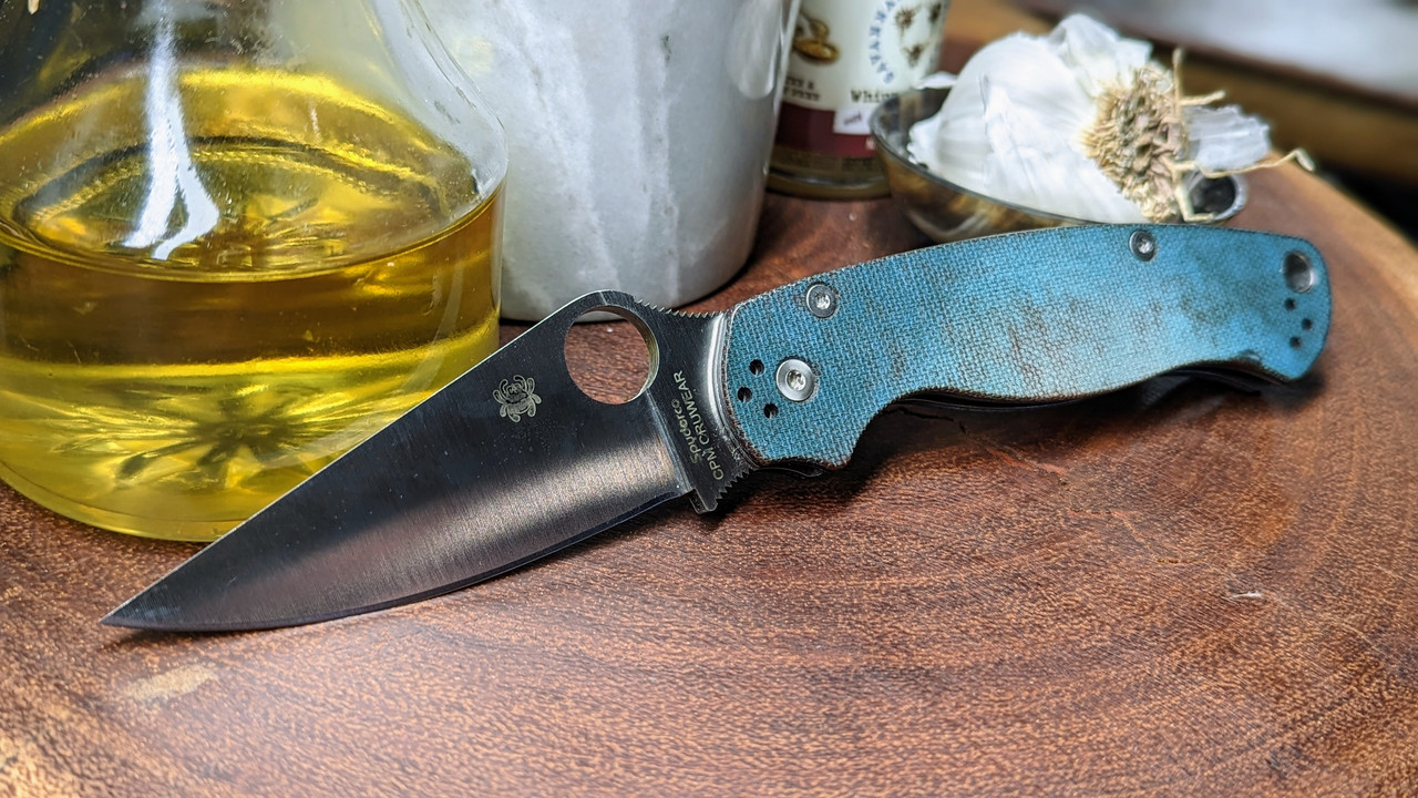

Really like the scales Jeff ! Did you do anything special prepping scales before application ? What temp was the Dye ? Buddy Dan
I just cleaned them up with dawn dish soap. Which worked pretty well. They were lighter then when I first got it. I treated the Micarta like G10, which meant I got the water to boiling in a pot. Added some Vaseline in random spots that I didn't want to soke up the dye. Did a light blue bath everywhere, then added more Vaseline and dipped the ends into a dark blue bath. The Vaseline was not as effective as I wanted. I wanted more brown in it. But I really like how it turned out. The blue with all the satin exposed is quite handsome.
I wasn't concerned if I screwed it up. I would have just dyed the whole thing dark blue. I really like the brown, but a blue Micarta is more interesting to me.

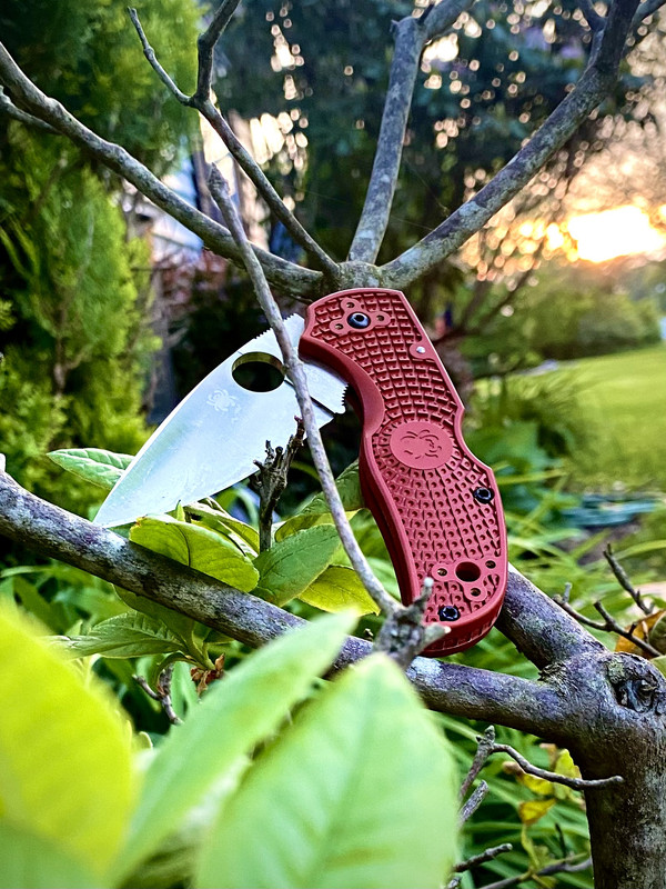

przemekspce
Posts: 699
Location: Poland
Re: Post up your Rit dye projects..
#383
Post by przemekspce »
benja-man
Posts: 134
Joined: Fri Apr 14, 2023 3:48 pm
#384
Post by benja-man »
przemekspce wrote:
Mon May 08, 2023 8:57 am
Nice! What color did you use?
przemekspce
Posts: 699
Location: Poland
#385
RitDye Kelly Green and iDye Poly Orange.

JSumm wrote:
Sun Mar 05, 2023 4:49 am
Sat Mar 04, 2023 6:46 pm
I like that!
It reminds me of a favorite pair of old jeans.
Nice job.

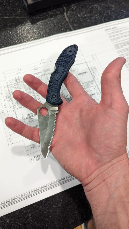

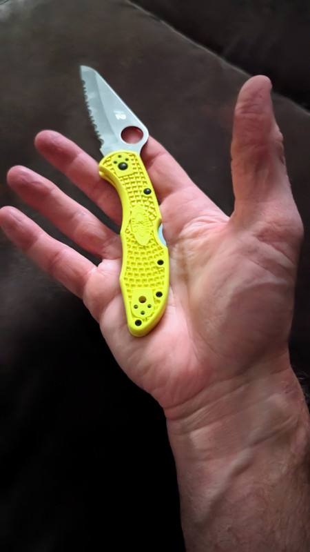

Posts: 6526
#400
Well the yellow didn't last 24 hours. I definitely see the value of high visibility, but most of the time I don't need it.
Aquamarine with a dash of Royal Blue.
