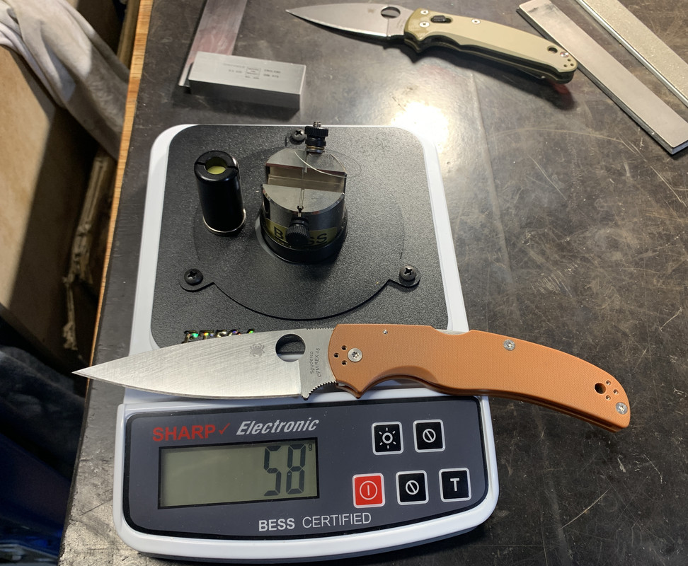

Sharpened some 15V this time.
Refreshed the edge on my PM2 with a 600gr Atoma since it's already at the angle I like. A number of light passes with each stone trying not to get a burr. Then a few passes of 1um stroppy stuff on leather.
Reprofiled my new 15V Manix 2 LW. When I got the knife I used it with the factory edge to break down a bunch of boxes to recycle and immediately remembered why I reprofile my stuff to a lower angle. Used my 400gr Vitrified stone to reprofile since it's faster to remove metal, a 400gr Atoma to clean up the work from the vitrified since it gives a crisper edge, then finished on the 600gr Atoma. 1um stroppy stuff on leather.
The heat treat on the 15V always a pleasure to sharpen as expected.

What angle did you sharpen the Manix to? Looks like 14-16dps?

It was freehanded and I just eyeball the bevels so not entirely sure tbh, but my freehanded edges usually end up between 11-13dps. On that note I went ahead and threw it in my guided system to check and this one is ~12.8dps according to the angle block thing, so call it 13dps.
Here's a couple shots of when I removed the small unsharpened section at the heel. Can see how much lower the angle was going to end up compared to the factory edge, which if I'm not mistaken are usually at ~16-17dps.

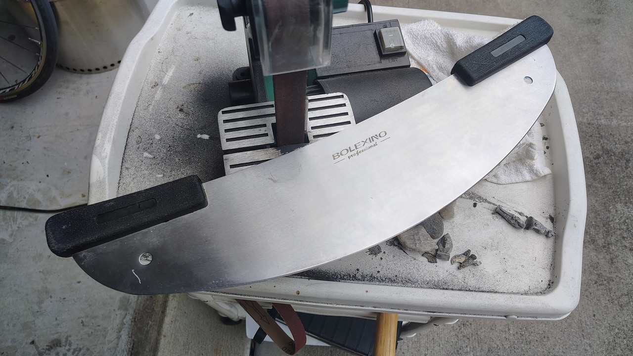

Nicely done, that must have been a pain. One of the modifications I did to my Harbor Freight 1x30 belt grinder was to remove the table, as since I was only going to be doing sharpening and blade regrinds where I was just going to be using the second modification I did to the grinder was add a piece of felt with just a very small amount of give, to add a natural convex to everything I ground, to the platen, which gave me my type of grind I like on a performance knife. What belt are you running on that grinder? I have an interest in abrasives, belts, stones, well I sharpen knives right?

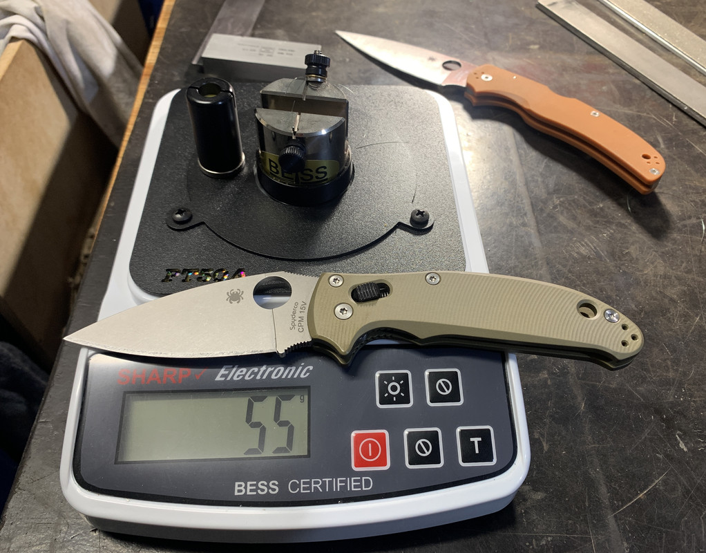

I got a second 15V Manix LW in the other day and went ahead and measured the factory edge on it, which came out to 16.85dps. With how wide the factory bevels look in the photo below even with an almost 17dps edge, that seems to confirm the BTE is probably pretty thin from the factory.
Bottom manix - straight out of the box factory edge 16.85dps
Top manix - the ~13dps sharpened example from my previous posts

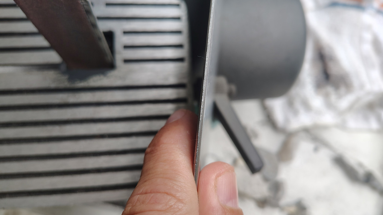

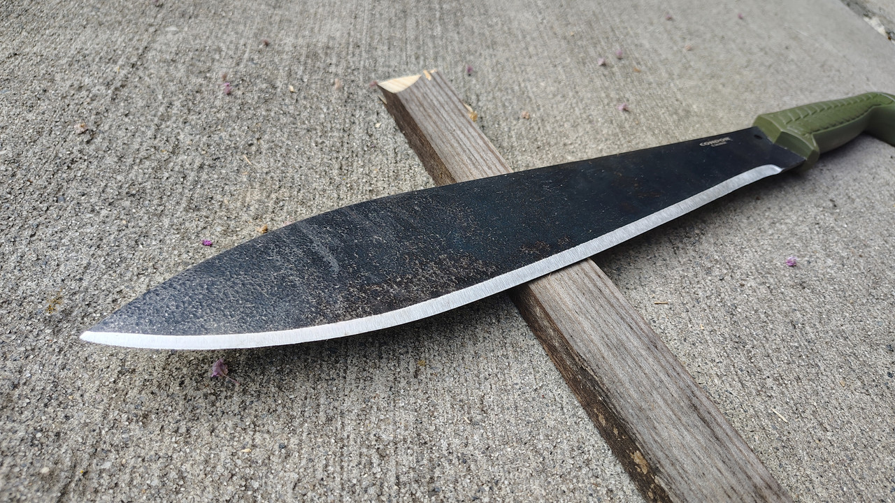

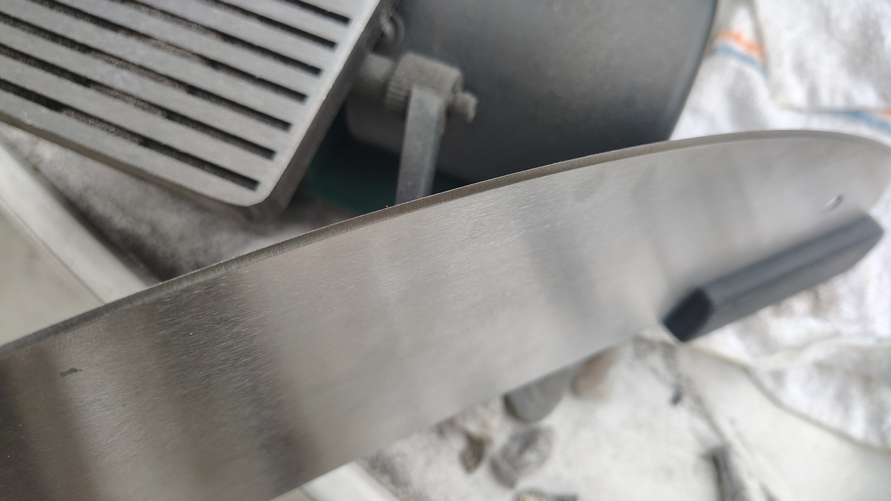

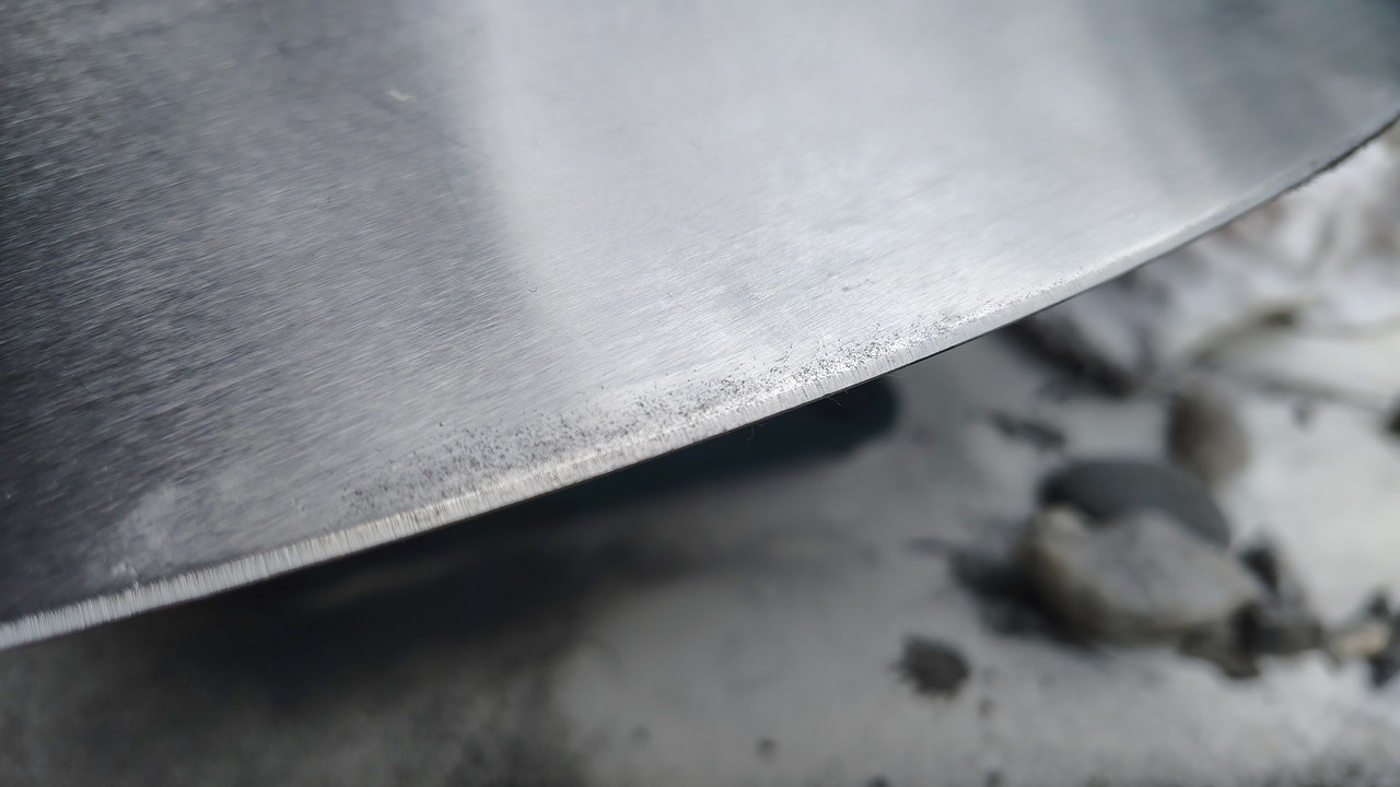

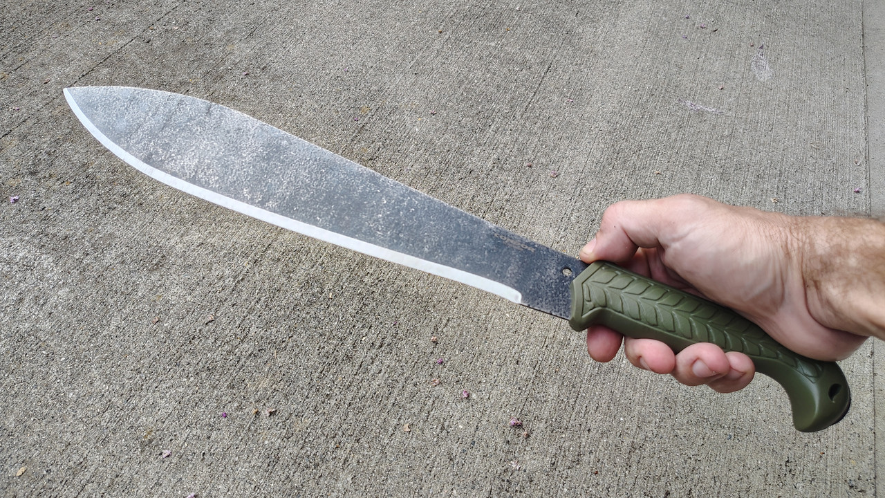

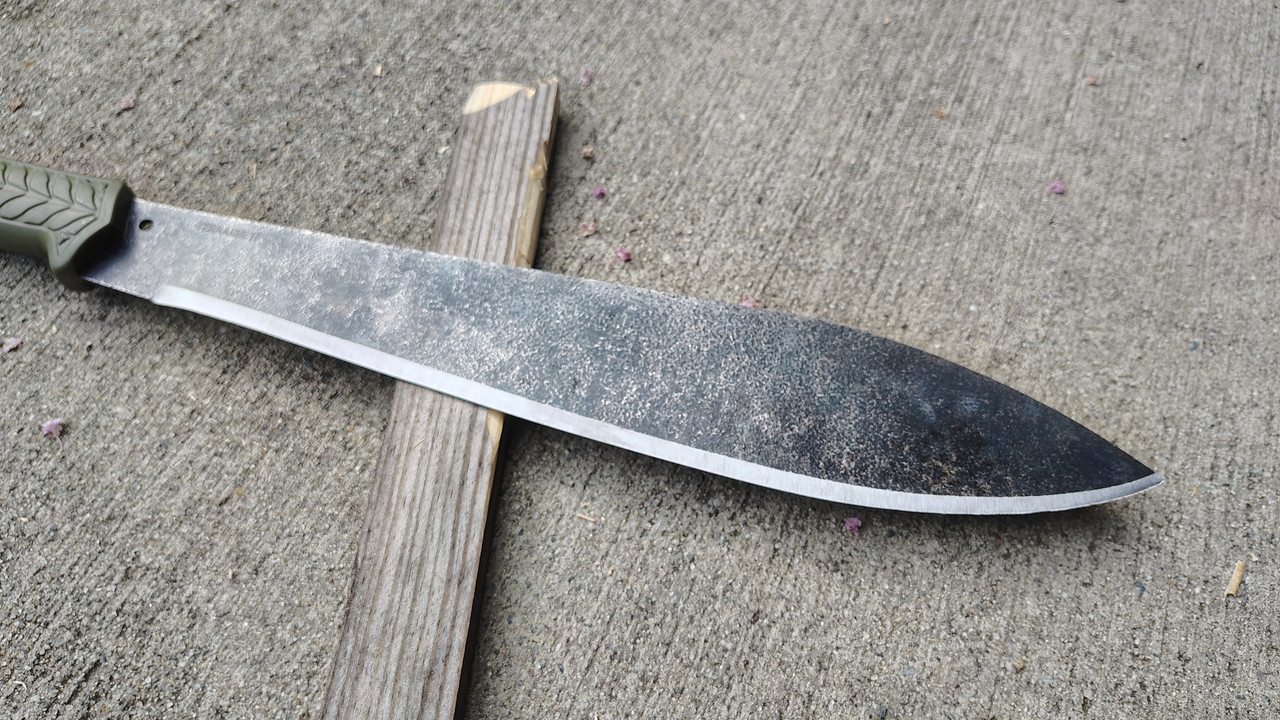

fixed my condor terrachete.
I had maybe 8 condor models on my list of knives / machetes I'm interested in, but I'm having second thoughts after seeing how thick their factory edges are.
This one was something silly like 30 degrees. Per side. Went through two of my 120 grit belts fixing it. Their steel is definitely harder than the south african cold steel machetes.
Shame about the neat dual grind being removed. I may incorporate that idea later on by bringing the first bit of edge even thinner. Cool idea but atrocious execution. The thinner part meant for carving is about the angle the entire machete needed to be to work well.
Shot videos of the whole process, including some test chops before and after. Whenever I find the time I'll put a youtube video together and share it.
Yeah, unfortunately you are not the first person I have heard who had problems with the edges Condor often ships, it seems like a pretty common issue. I don't really care how sharp a knife is out of the box as long as it has some sort of edge, but that kind of thinning would probably be a problem for me considering I don't have power tools at my disposal.

reprofiling a delica with bench stones is one thing, but I wouldn't recommend this machete to anyone without access to a belt sander. It took me about half an hour to reprofile it with one, while most my cold steels took about 5 minutes. combination of absurd edge thickness and harder steel, plus being careful with the combo grind until I was ready to blend it in with the rest of the bevel.
it seems like a solid design otherwise. I'm gonna do some more test chopping here in a bit.

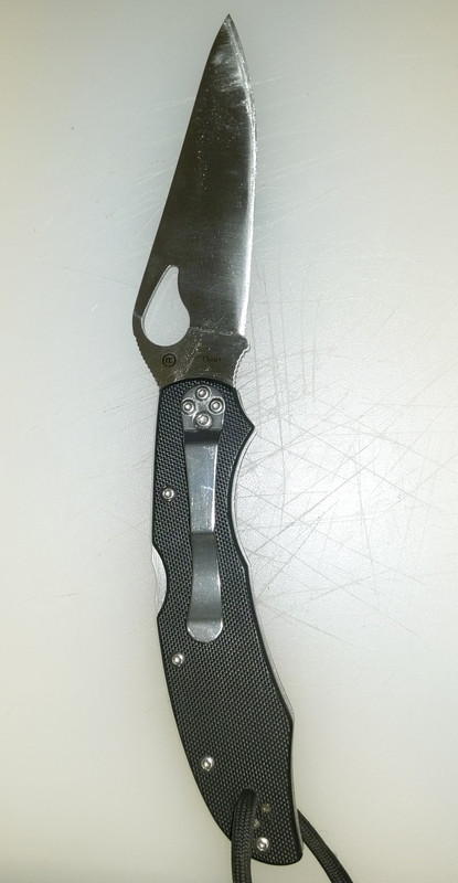

Just sharpened this one again. This is what I've been carrying for over a month now (except on my runs). Apexed on a 240, then refined and deburred on a 320.
Toothy, but grabs & pops hair above skin :-)
You may not be able to tell ;) but I've dropped the edge angle just a touch for a bit narrower BTE.
It just falls thru things.

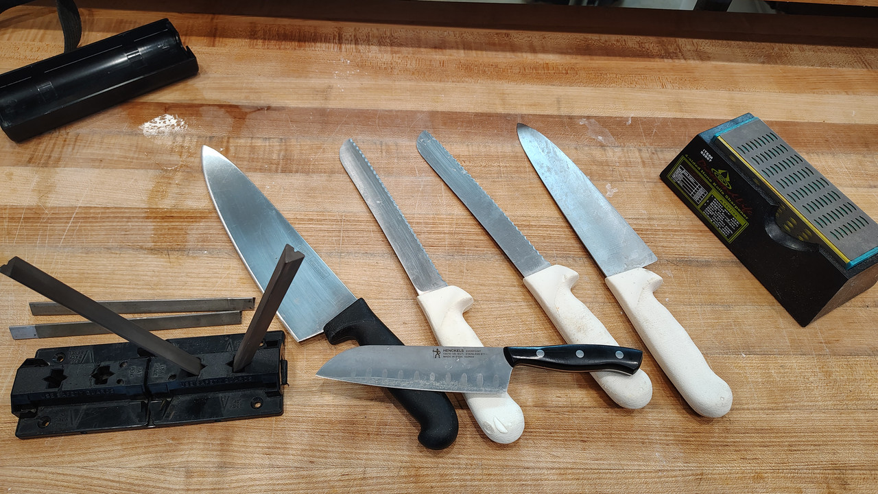

touching up some beaters for our kitchen house knives.
diamond rods to bring the serrated dexters back to life. 300 grit diamond plate followed by brown rods for the plain edges ones.
the black handled portugese chef knive was one I got free when an old employer of mine closed down, and the rest are $10 dexters & henckels that get treated rough.
someones gonna cut themselves today despite my warnings, haha. happens every time.
