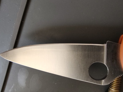

I see you've now edited your post, Paul, but you're probably spending too much time, or using far too much pressure. SuperGold2 is quite a breeze to sharpen, especially with diamond, or similarly hardened abrasives.
Make Knife Grinds Thin Again.
- Paul Ardbeg
- Posts: 1595
Re: Community Sharpening Journal, Part 2
Yeah, went a bit to hard on that one. I did not use the more coarse stones this time. I did dropped the edge angle to 12-13 DPS after a post from Vivi. The measurements on the Edge Pro go from 10 to 15 degrees and i've put it in the middle. The first centimeter behind the recasso is not the prettiest, but happy with the result after that. Now to use it and see how it holds up. Of course some of the particles rubbed off on the softer SUS410 scratching it a bit, same happened with my Caly 3.5 in ZDP-189weeping minora wrote: ↑Mon May 19, 2025 3:23 pmI see you've now edited your post, Paul, but you're probably spending too much time, or using far too much pressure. SuperGold2 is quite a breeze to sharpen, especially with diamond, or similarly hardened abrasives.
Any advice is as always appreciated!

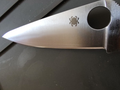

SUS410 scratches if you look at it too hardPaul Ardbeg wrote: ↑Thu May 22, 2025 12:02 pmYeah, went a bit to hard on that one. I did not use the more coarse stones this time. I did dropped the edge angle to 12-13 DPS after a post from Vivi. The measurements on the Edge Pro go from 10 to 15 degrees and i've put it in the middle. The first centimeter behind the recasso is not the prettiest, but happy with the result after that. Now to use it and see how it holds up. Of course some of the particles rubbed off on the softer SUS410 scratching it a bit, same happened with my Caly 3.5 in ZDP-189weeping minora wrote: ↑Mon May 19, 2025 3:23 pmI see you've now edited your post, Paul, but you're probably spending too much time, or using far too much pressure. SuperGold2 is quite a breeze to sharpen, especially with diamond, or similarly hardened abrasives.

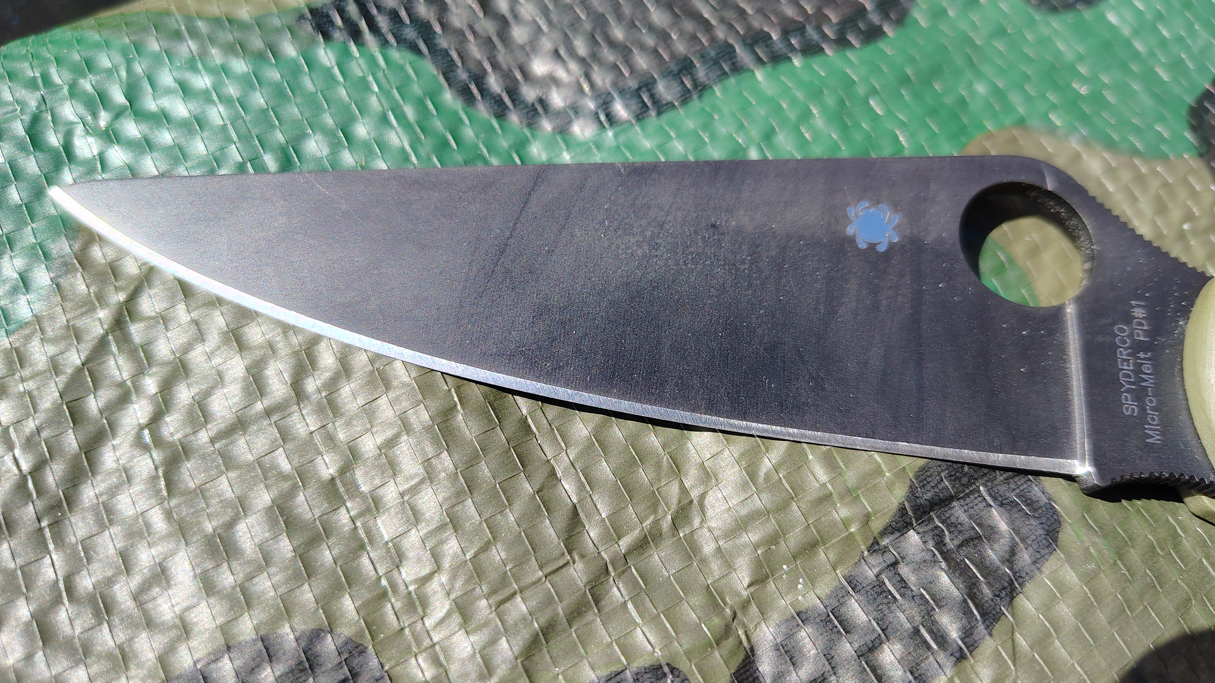

Took my PD1 Police just a bit thinner, and got the full edge sharpened.
Used my 120 grit chef knives to go diamond plate to reset the edge, then polished it on a DMT Coarse. Followed up by one stroke per side on my medium sharpmaker rods I reground to be a bit coarser.
Very grabby edge.
Someday I'll take it a little thinner. I went thinner with my VG10 and K390 Police folders and had no issues, and I think PD1 is tougher than either of those steels.

That edge looks pretty good. The primary grind must be quite thin, because that bevel is much narrower than expected at 13 DPS.Paul Ardbeg wrote: ↑Thu May 22, 2025 12:02 pm...some of the particles rubbed off on the softer SUS410 scratching it a bit...
Do you use the EP water stones, or diamond stones? I used to get slurry scratches on all my blades while I still used the water stones, even though I tried to prevent it. Diamond stones mostly solved that problem.
- Paul Ardbeg
- Posts: 1595
Thanks Hans! It's diamond stones on the Edge Pro. I only get it on the soft outer layer steel on these "San Mai" wrapped blades.Brock O Lee wrote: ↑Thu May 22, 2025 5:18 pmThat edge looks pretty good. The primary grind must be quite thin, because that bevel is much narrower than expected at 13 DPS.Paul Ardbeg wrote: ↑Thu May 22, 2025 12:02 pm...some of the particles rubbed off on the softer SUS410 scratching it a bit...

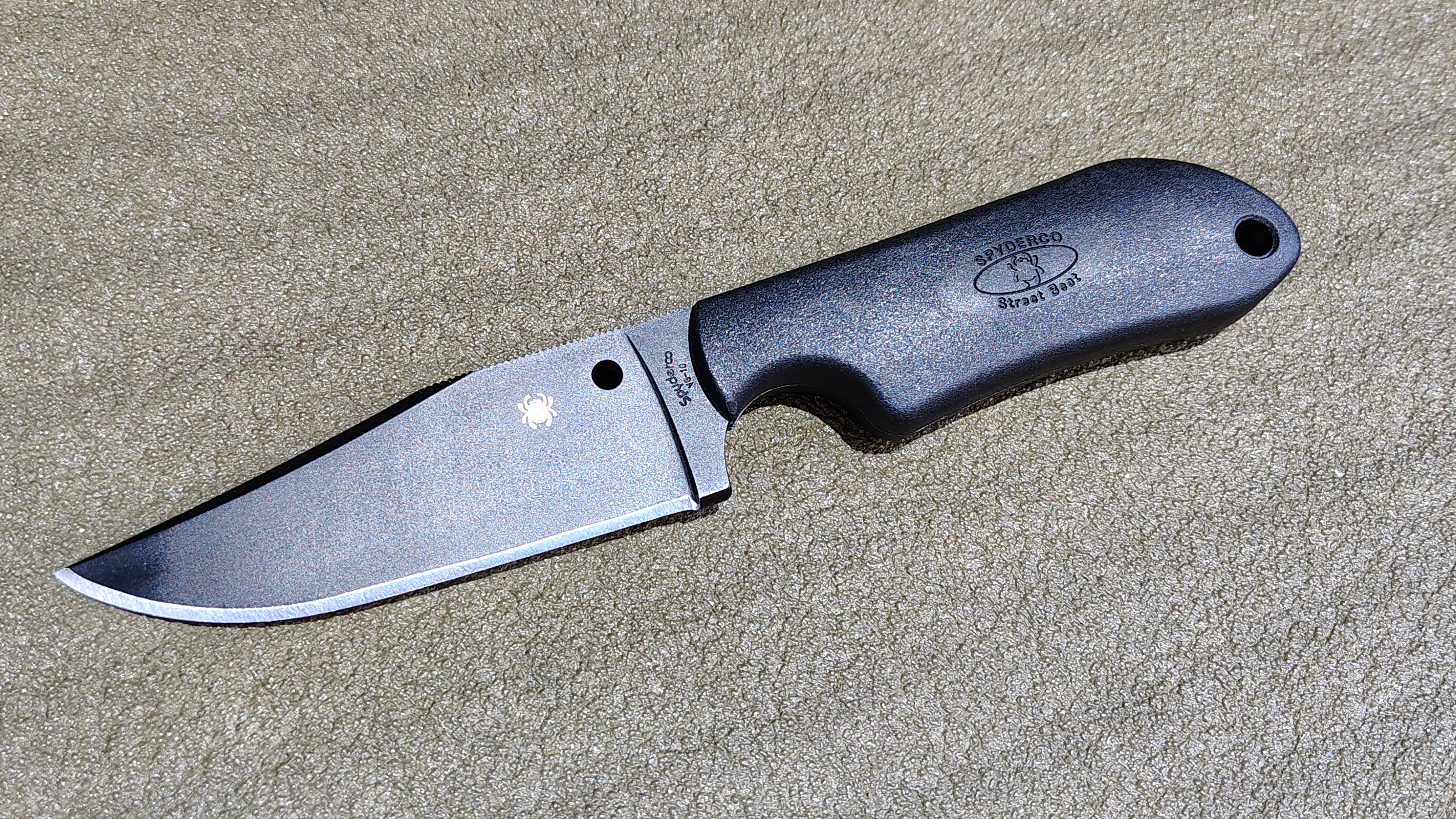

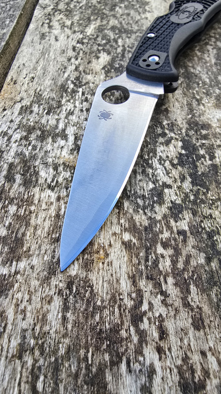

did a little more work on my street beat.
Very thin and sharp now. Excited to put it to some use.

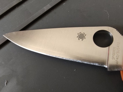

Had a slow day at work today, so I decided to free-hand reprofile the HAP40 Endura. I took it down to about 14 or 15 degrees per side. Turned out great. Its super sharp and super slicey now. This is the first time I've tried free hand reprofiling on one of my "good" knives. Before, I did my factory 2nd PM2, and a second hand Native 5 that was kind of beat up. But the more I free hand, the easier it gets. And my confidence and skill are growing.

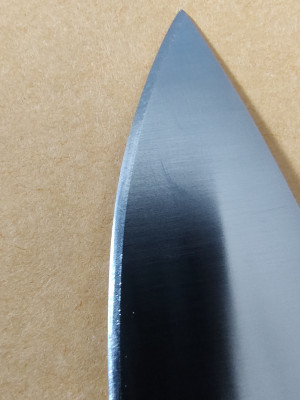

This is the Landi Bushcrafter.
It was a really, really nice knife except for one problem. The edge was way, way too thick. It felt terrible to cut with.
I tried thinning it out but he heat treats his A2 pretty hard, 61-62rc or so, and it felt like it'd just skate off the stones. It took a long to grind time for such a simple carbon steel, and I never finished the bevel.
At one point I took it to my belt sander and gave it a much thinner edge, but it was really uneven and I never got around to cleaning it up.
It was pretty ugly at this point. Handle was pretty grungy too. Clean micarta grips much better.
Last night I decided to try to make it work before buying anything new.
I gave it a full convex grind by hand with some 100 grit sandpaper.
Polished it up with 400 a bit then sharpened the edge free hand on my medium then fine ceramic bench stones. Got it cleanly shaving from heel to tip, and quite thin.
Cleaned the handle up a bit and scuffed it up with 80 grit sandpaper for better grip.
Eyeball estimate puts it around 18-20 degrees inclusive, with some light finishing strokes on the fine ceramic at about 15dps.
Tried carving some simple feather sticks and it cuts as well as anything else I own now.
This picture shows how thin it is better than others. convex edges are tough to photograph with phones.
Happy with how it turned out. This'll do nicely for my next backpacking trip.

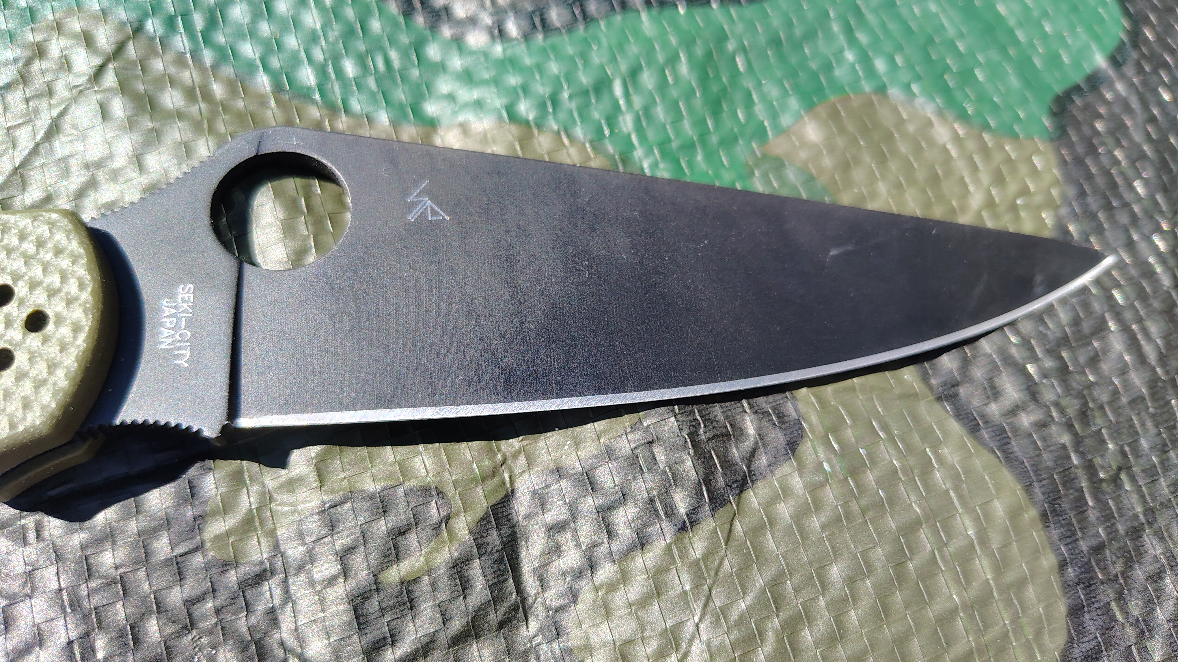

I just finished a free-hand reprofile of my Manix 2 XL. I took it down to about 12 degrees per side using nothing but my Harbor Freight diamond plates and a leather strop with 1 micron diamond paste on the rough side and naked leather on the smooth side.
I'm very pleased with the results. I think I've really got the muscle memory down now, so it's easy to get a good even bevel on both sides of the blade.
