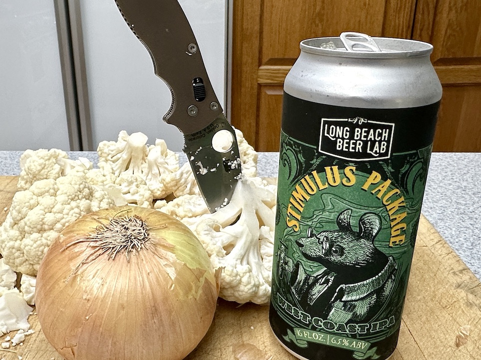

Here's another 15V shot.
The Manix 2 is the perfect knife for cutting up cauliflower.
For dicing onions, it's too short. But it was already dirty, and I didn't want to clean two knives.

Nice! Put that 15V to work! It's not just for collecting.
