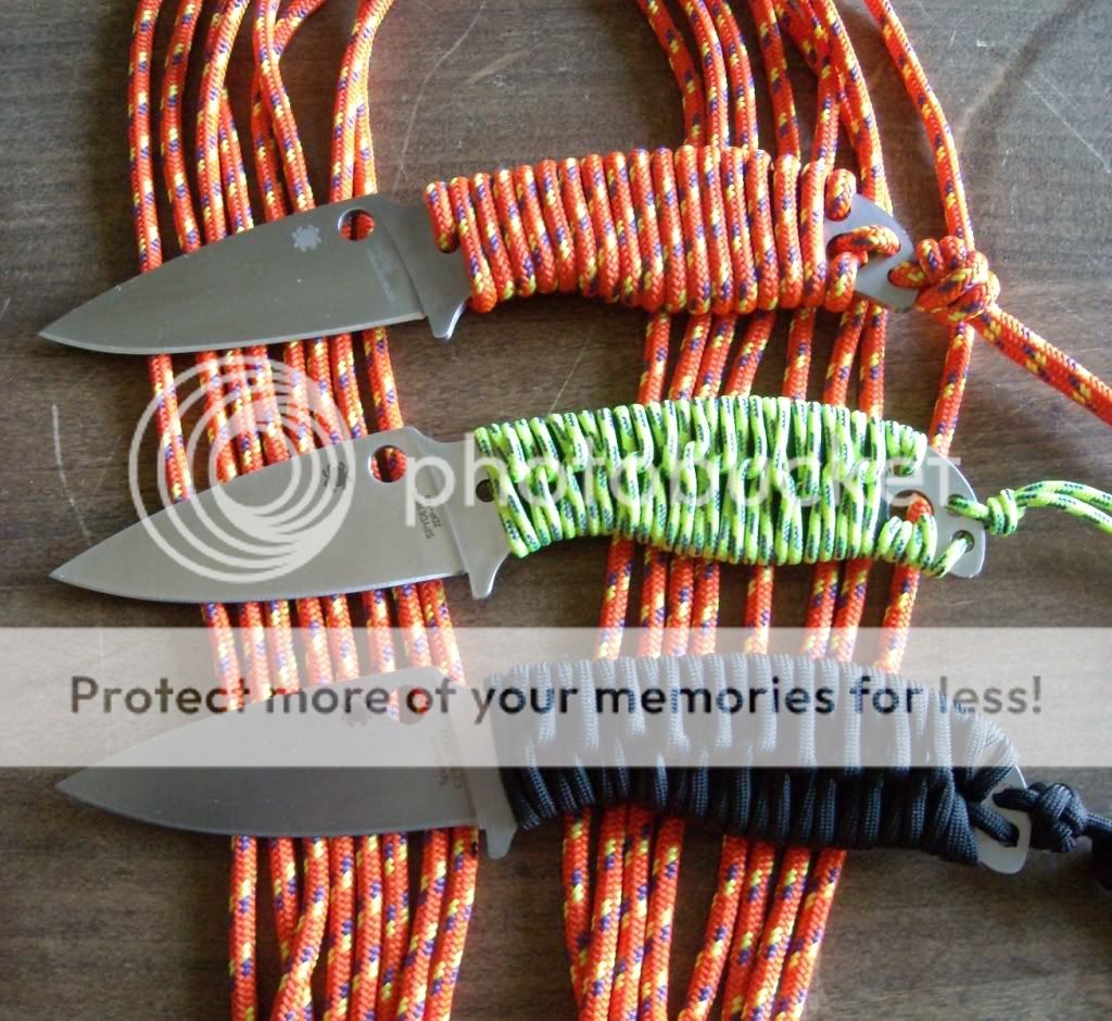

#202
Post by VashHash »
My first time doing a wrap it's not the best looking but it's really grippy and THICK

#204
Post by VashHash »
When i order my carbon fiber i'll probably get rid of the gaurds of the mules i have. Don't really like it but it helps hold the cord wrap in place
