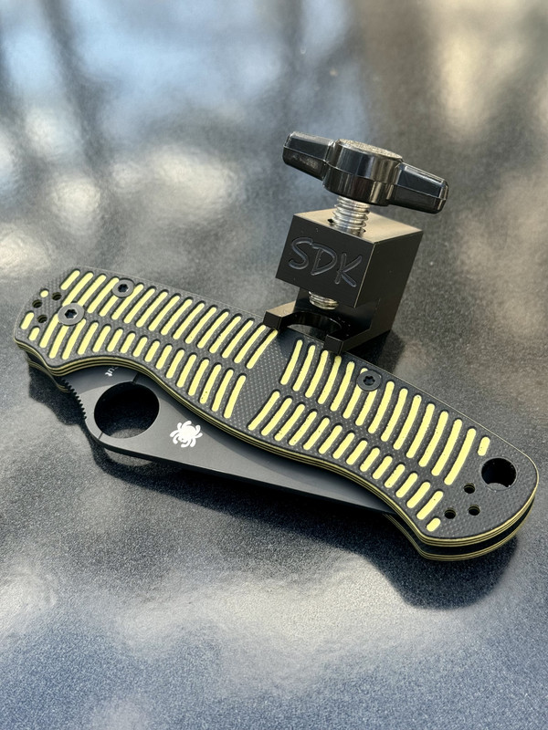

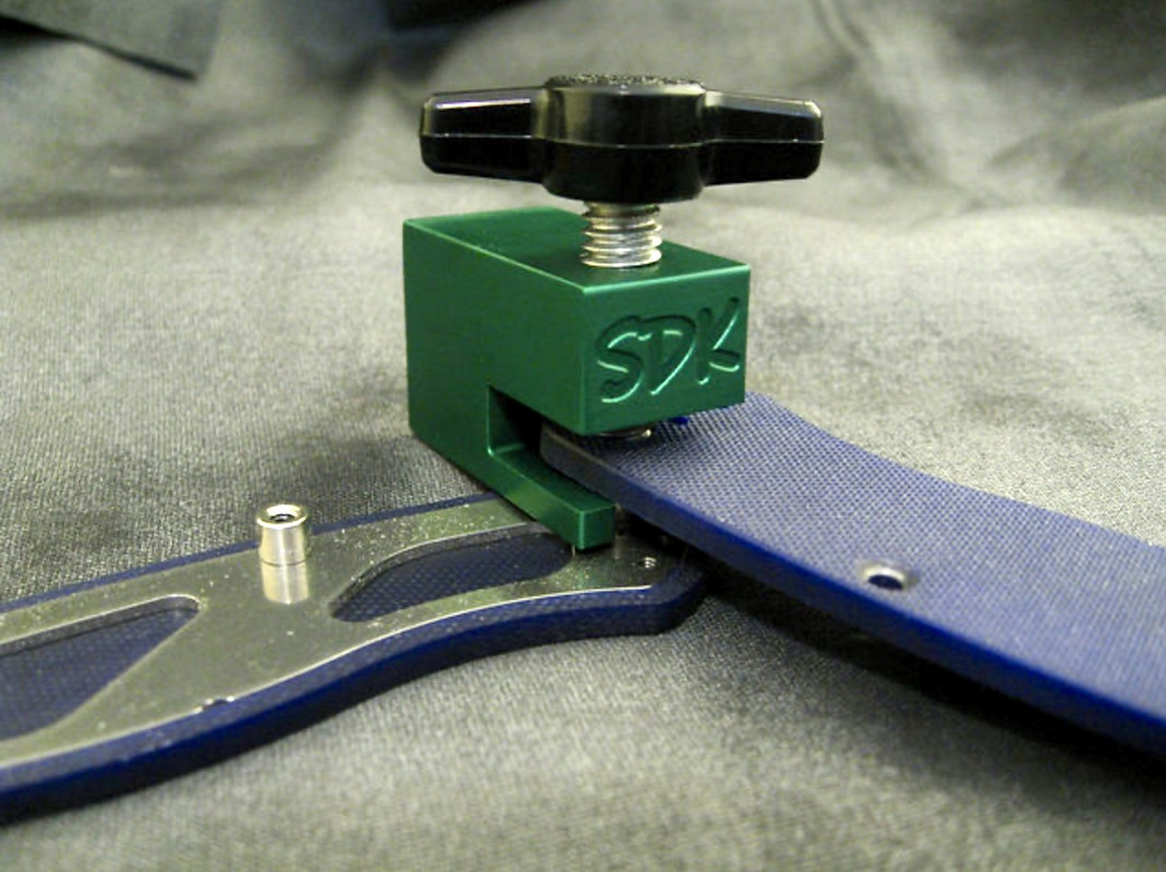

Posts: 5647
Re: Military 2 help
#34
Lanyard tube removal tool from Sharp Dressed Knives is awesome…changed out my PM2 salts in 5 minutes 👍
Posts: 3585
Re: Military 2 help
#35
Tue Mar 04, 2025 4:36 am
I have one too. It’s a great idea. Mostly works well. Only issue I’ve had with mine is the bolt will flare the tube more and make the tube in useable for future use. I’ve overcome that by using a shim to go between the bolt and tube. Now I can work it flawlessly.
Posts: 5647
Re: Military 2 help
#36
Tue Mar 04, 2025 6:08 am
I’ve had no problems with mine but I’m sure you’ve used yours way more than me…the shim is a good idea and one I’ll use 👍

Posts: 3585
Re: Military 2 help
#38
Kleon wrote:
Wed Mar 05, 2025 6:02 am
@MrJ what does this shim look like? Can you post some pics for me? I have the same tool and would love to fix this issue as well. Appreciate it!
So usually what happens is: I use a screw driver to separate the first side. Then I’m stuck with the other liner, scale and tube. You can get the second scale off but the liner gets stuck on the tube. I just garb a dime and put it between the bolt and tube. Then crank the removal tool down. It pushes the tube flush with liner where you can easily separate. If you just use the tool to do it all the bolt will eventually wear out and seat inside the tube flaring it more. Which makes it harder to remove and worthless for reusing. It won’t fit in new scales after that. I’ll post a picture later when I get time.
Posts: 3984
Re: Military 2 help
#39
Yup this tools works for me too. It was a grudge purchase, but got me out of a situation once where the lanyard tube was flared so much that it was well and truly stuck in the steel liner.
