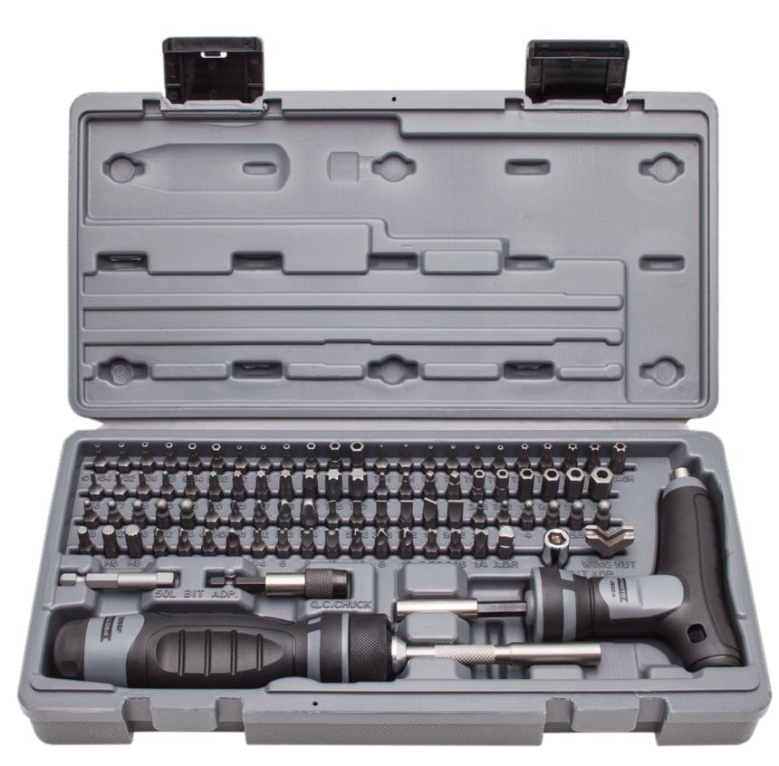

If the little wrench in my Wiha kit doesn't get it done...
Then the big screwdriver in this Proto kit will do it or I call out the big T handle and then it's either break free or get drilled out.
