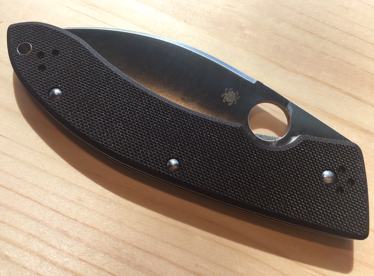

Formerly a Pink Large Lum Chinese Folder, now a plumb/eggplant deep brown purple.

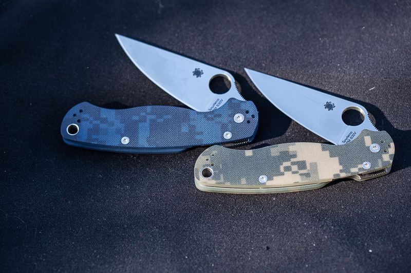

I RIT dyed the first PM2 I got. The digital camo version. Used blue dye (royal blue) and it came out pretty good I think. I took the knife entirely apart to do it, which was easy enough, with one exception. Namely the lanyard tube. They apparently crimp that on (or in) so that the scales don't just slip off. If was the dickens to pry the scales off the tube, and if I do it again (which is extremely unlikely), I think I would just dunk the whole knife. But everything worked out fine.
