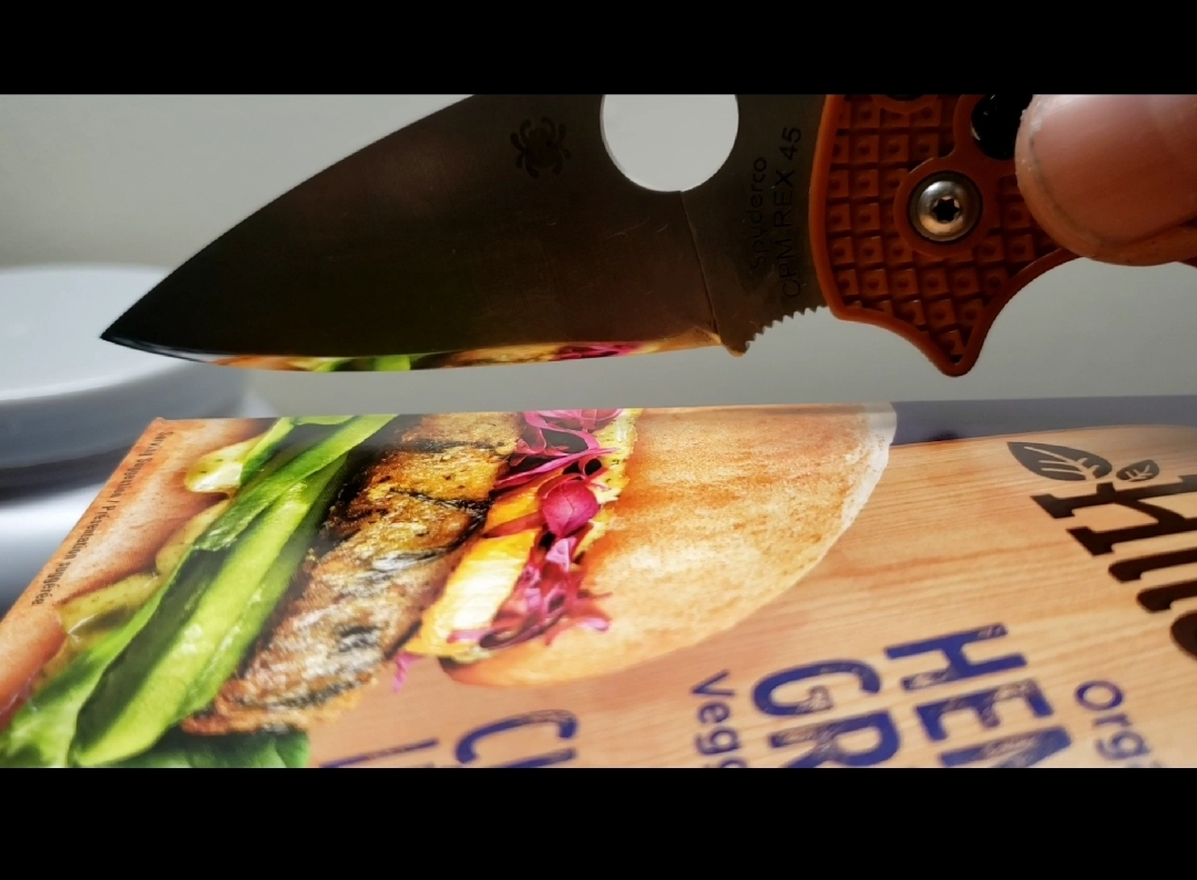

I just touched up two of my favorite carbon blades: Manix2lw in Rex45 and Endela K390
Manix2lw fresh off the stones, no stopping, finished on F1500 diamond stone, scary sharp

northvanbamboo wrote:
Fri Feb 17, 2023 9:20 am
Endela finished on uf spyderco stone, 1/2micron diamond paste on leather, not as aggressive and keen as Manix2lw
Have you ever tried Rex45 with a toothy finish? Takes a lot less time, and cuts like like a dream!
