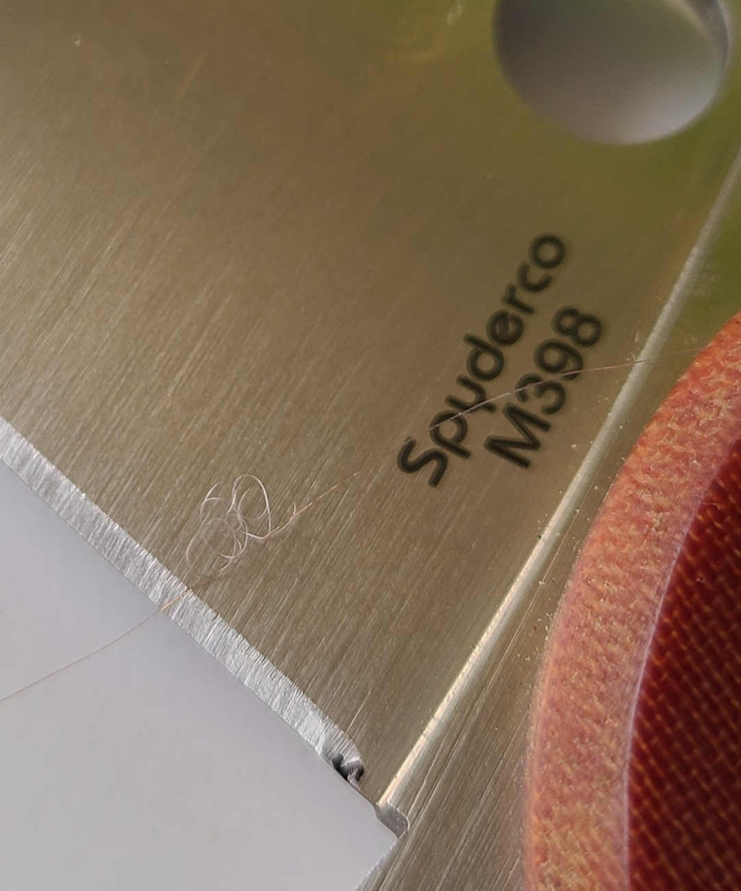

First sharpening of my M398 Mule on the WSPA. Don't like how the stones can't reach the whole bevel. I also don't really like the WSPA diamond plates, they seem to have quite a few stray grit particles that are too coarse for what they're rated. I saw them on the fine plate when it was new and hoped the would break off during break in. You can actually feel them as your sharpening almost like it's dirty. Not a big deal unless you're trying to get hair whittling edges. Had to finish freehand with Jende 1 micron on leather to get that sharp.
Posts: 13861
Re: Community Sharpening Journal
#1727
Hmm, that's strange. I've sharpened my Mule on the PA with no issues, also done filet knives that are even longer. Did you compensate by where you connected the clamp to the blade and move those rubber bumpers on the sharpening arm?
- Rick
Josh Crutchley
Posts: 1426
Location: Michigan
#1728
Post by Josh Crutchley »
Sun Feb 12, 2023 2:40 pm
The stone holder runs into the nub so I can't sharpen all the way to the plunge.
