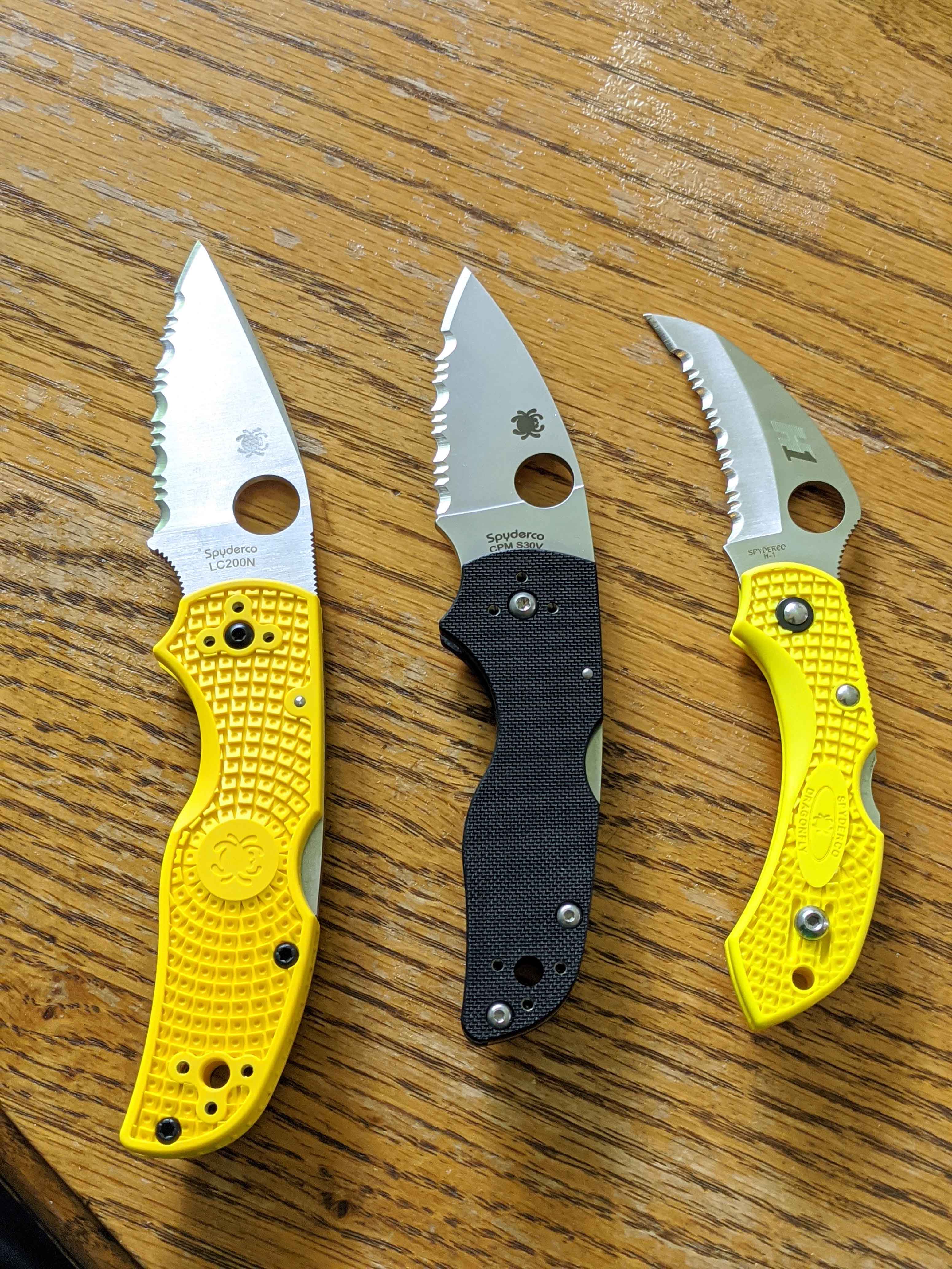

Over the past ~year i have gained a bit of skill and confidence sharpening serrated edges. The community here and knowledge sharing, combined with the SharpMaker have really facilitated my increased enthusiasm for serrated edges.
I have used and carried my Byrd Rescue as a gardening and work knife for some time and find it both useful and easy to keep sharp. I have also taken to sharpening the many cheap Victorinox paring knives that bang around our kitchen. The SharpMaker makes this task a breeze, although i guess the same can be done with the edge of a stone.
This experience led me to want to try out some FFG SE blades in "better" steels. I have been wanting to try LC200n in SE after loving it in PE edges, and i wanted to try SE S30V, H1 and an SE hawkbill. After much consideration, i ended up ordering three smallish SE knives.
They are: the Native Salt in SE, the Lil Native Backlock in SE and the Dragonfly Salt Hawkbill.
So far i am very pleased with all 3. I already knew that i quite like my PE Native Salt, so that was easy.
Then I challenged myself a bit to try smaller Spyderco models. I really like the entire Native family and quite surprised how much i like the Lil. The Dragonfly is also cool. I think i would like it in a wharncliffe blade too.
