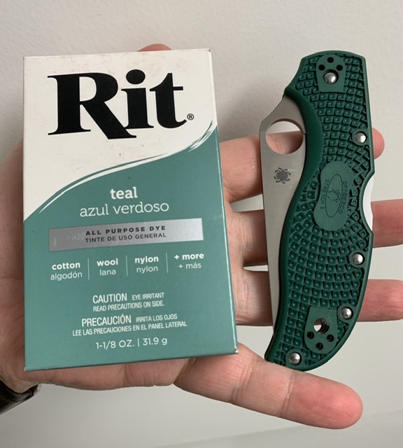

That is darn strange how real came out Forrest green on the Ivory SSS. Did you trey a different soak time? Do you think longer would provide the correct color?

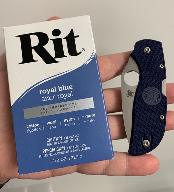

Hard to say, the rit teal is more green than blue though and the knife came out darker than the packaging. That said I only dipped it for 30 minutes, and paper towel tests were definitely more blue, so the natural color of the ivory may have had a subtle effect as well. I would be interested to see the difference on a yellow salt, but for this one I would have given it another short bath in a light blue if anything. I was happy with the rich green since it's not a shade I have anything else in.
JuPaul wrote: I tried to do a dark purple on the chap lw I had, but I couldn't get it darker than a lavender color, soaked maybe an hour. I think i just used the liquid RIT, boiling water and vinegar...did you add anything else to the mix on that one? Longer soak time?
Nothing special, I use the powder which calls for dish soap and salt in addition to vinegar. I haven't had to take anything much past a half hour and the chap may have been less closer to 20. It was a royal blue dye though not navy and it still came out quite a bit darker, so I'm surprised lightness was your issue :confused:
