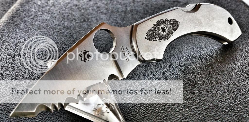

My little job and finish :D
Original not Spydie, but now looks Spydie. :D
