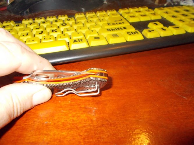

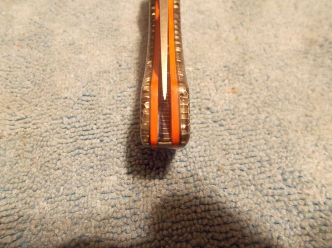

This project took 3 attempts to get it right. Now I don't have any complaints and it is in my EDC group. :D
Notice the first back spacer I made and the one that is there now. The first one had a straight bottom (inside handle) like the original D'fly.
First attempt.
This is how it looks now. The bottom (inside) follows the curve of the blade edge.
FYI: The reason this took 3 tries is the backspacer's thickness being perfectly even is essential for proper operation (and looks). Now I know the perfect thickness needs to be established BEFORE gluing to either side of the handle. Sanding C-TEK this thin makes it extremely fragile. I wanted to glue the backspacer to one side of the handle before sanding it this thin so the material wouldn't flex causing it to seperate where the aluminum "walls" are.

Very nice, Jack. I hate learning the hard way, but now you have wisdom - from yourself, not a book, or someone else.
Your keypad's cool, too. :)
