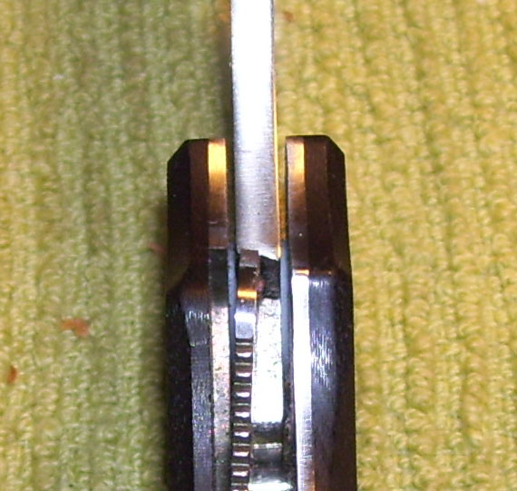

Hello. I just purchased a NIB Jason Breeden Rescue. I love the blade, and I figured I'd kick myself if I didn't pick one of these up while they are still available.
My question is about the liner lock. How far over is the liner supposed to engage on the tang when the knife is brand new? I attached a photo, perhaps others in the know about the Spyderco factory specs for liner locks can help me out. It looks like it's not early lock up...but maybe these liner locks don't travel too much over time?
Does my new Breeden Rescue lock up correctly?
Any thoughts would be appreciated.

I'm no expert on liner/frame locks :eek:Cheddarnut wrote:Is it safe to assume anything early enough to not completely engage is too early?
I don't think so. It depends on the knife and the locks design intent. :) The PPT locks up at 50 to 70% and I've had no problems, then again the metal is a bit thicker and the inward force of the liner/frame is different. Angles on the liner/blade might be different providing greater or lesser support. Also intent of use would also play a role?
For the Breeden 100% seems appropriate for me :)

With frame-locks, my understanding is that the lockbar should engage about 50% onto to the tang of the blade. At least that's what I recall.
Liner locks are a bit different since the contact area is less wide. Still, most would say early lock-up is better than late as you have more "life in the lock" to move from one side to the other. I believe it's also a bit stronger via geometry.
The problem that I've seen is optimal geometry (early) vs optimal chance of lock-up (late). Early locking knives with a bit of debris and/or a less than assertive snap sometimes don't engage all the way. I prefer a bit more engagement as it's easier to gauge and less resistant to accidental unlockings. That and the "life in the lock", IMHO, is played up quite a bit with SS components. Even traveled all the way over, if the tool otherwise seems secure it wouldn't dissuade me from normal use.

Thanks to everyone for all the feedback.
I'm thinking that my model is perfectly within spec insofar as the percentage of liner engagement.

I agree with most all of what Blake is saying. I would certainly trust a framelock at 99% much sooner than a super early lockup at 5% or even 10%. What good is early lockup and lock break-in if you have no fingers to hold said knife. Geometry is obviously important also, but I think too much emphasis was placed on "early lockup" by way too many reviewers. This is important if you plan to sit and flip the **** out of your knives. If you have this much nervous energy, may I suggest these for repetitive action to calm your nerves.Blerv wrote:With frame-locks, my understanding is that the lockbar should engage about 50% onto to the tang of the blade. At least that's what I recall.
Okay, rant over. Back on topic.
Linerlocks by Spyderco have in my experience locked between 30% and 60%. I don't really recall noticing any wear in with my Military models after years of use. Yours looks good for years of use!
