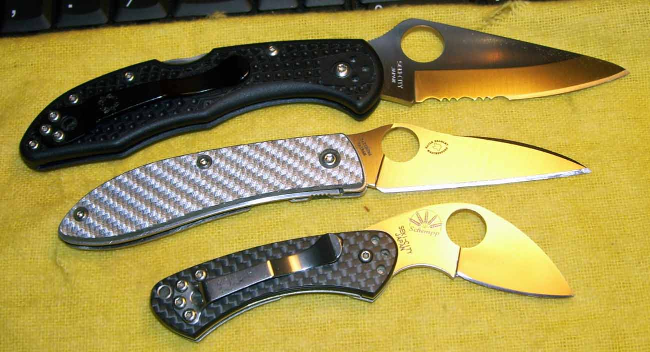

I blame Spyderco's material choices for the malady I've developed ;) As I've been getting better at making the bevels meet in the middle with precision my expectations and standards for what sharp is have correspondly increased :eek: Materials like VG-10, ZDP, S30V, CPM M4 etc. make it easy to fall into this progressive condition.
I am not satified with an edge now unless the making of it has pushed my limited skill and tools to the limit ;) I feel this is a chronic condition :eek: Getting an edge sharper and sharper is analogous to a mathematical limit approaching zero :eek:
This is a nutty condition ;) However it does bring some tangible results :D Very sharp or "nutty sharp" is a very enjoyable result :D
Anyone else have this affliction???

I'm with you Charlie. Those edges look great, by the way!
