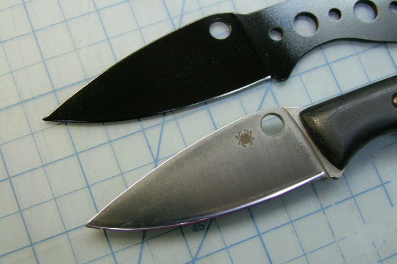

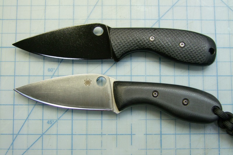

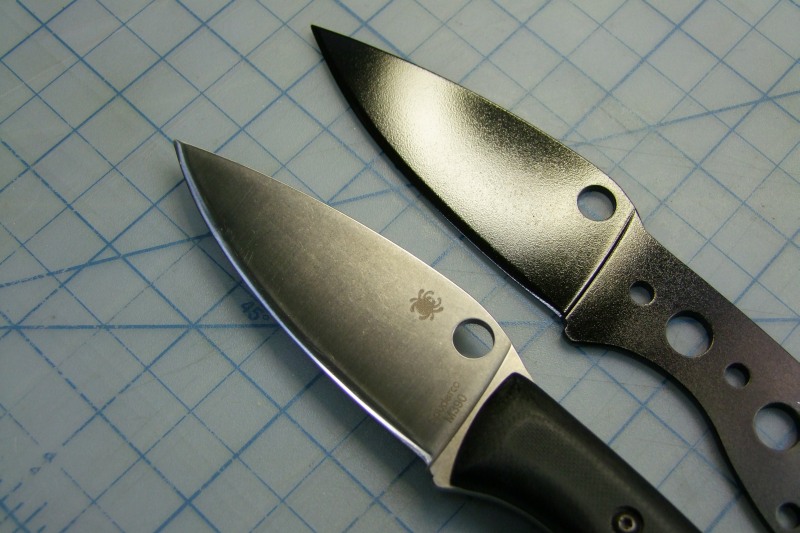

I have been wanting to try Moly Resin to protect the steel on my Cruware mule (prevent long term corrosion), but I was a little worried about the 300F curing time for Moly Resin (same for Cerakote) as 300F is awfully close to the temperature for tempering many steels. However, I found that Cruware's tempering temp is around 1000F, so 300F was not even close to affect its hardness, so I gave it a try.
After sandblasting the finish, I applied and cured the semi-gloss black Moly Resin (M390 mule shown for comparison):
Lets see how it holds up :D
