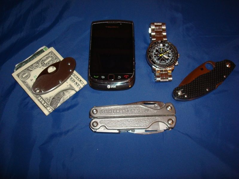

Show your EDC
Agent_Ohm
Posts: 436
Joined: Tue Apr 22, 2008 5:22 pm
#1361
Post by Agent_Ohm »
fog edc by Agent_Ohm, on Flickr
In omnia paratus
tr4022

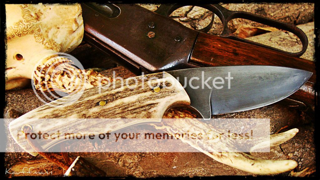

This one just arrived. A Warncliff from a local maker Stuart Smith!

Nice Wharnie, what steel?

Post by Zenith »
Azwaiian wrote:Beautiful!
Donut wrote:Nice Wharnie, what steel?
Thanks for the kind words. Here is some info on the steel.
SABEN SILVER STEEL 1.2210 PRECISION GROUND DOWELL ROD B.S.1407 WERKSTOFF No
C 1.20
Si
Mn 0.40
Cr 0.40
Mo
W
V
Features and Uses
Saben Silver Steel is bright finished rod produced from hot rolled bar by means of centreless grinding.
The high carbon content of this steel means that it can be hardened to give considerable wear resistance and the chromium content adds to the strength and hardenability
As supplied however, the steel is machinable owing to the annealing treatment given to it prior to grinding.
Saben silver steel is spherodise annealed for best machinability, the annealed hardness being in the region of 270 Brinell (Rockwell C27). On hardening and tempering a hardness of up to Rockwell C64 can be obtained. Being in the spherodised condition, the material offers maximum response to hardening and the chromium content ensures deep hardening.
Applications
Saben silver steel finds innumerable uses in the tool room and in general engineering. The user can select a size suitable for his purpose, thereby reducing or eliminating the need for grinding or machining the finished part.
Applications include screwdrivers, punches, shafts,
axles, pinions, pins, die posts, instrument parts, model parts, taps and drills for mild steel, engravers tools, and fine cutters.
Hardening
It is preferable to heat the tools in a controlled atmosphere. If this is not possible, pack hardening is recommended. A reducing atmosphere is desirable.
Heat to 770 / 780ºC and when thoroughly soaked through, quench in water. (sizes up to 8 mm diameter may be oil hardened from 800 / 810ºC)
Tempering will be necessary.
Tolerances
B.S. 1407/1959 conforms with I.S.O. H8
Up to and including 3mm +0.00 – 0.014 mm
Over 3mm and including 6mm +0.00 – 0.018 mm
6mm and including 10 mm +0.00 – 0.022 mm
10mm and including 18 mm +0.00 – 0.027 mm
18mm and including 30 mm +0.00 – 0.033 mm
30mm and including 50 mm +0.00 – 0.039 mm
Tempering
Temper according to the purpose for which the parts are required generally between 150 / 300ºC
Rockwell C Temperature
63/65 as quenched
63/65 120ºC
64/62 150ºC
62/61 200ºC
59/58 250ºC
56/55 300ºC
54/53 350ºC
50/48 400ºC
Temper at about 230degC and get great performance
