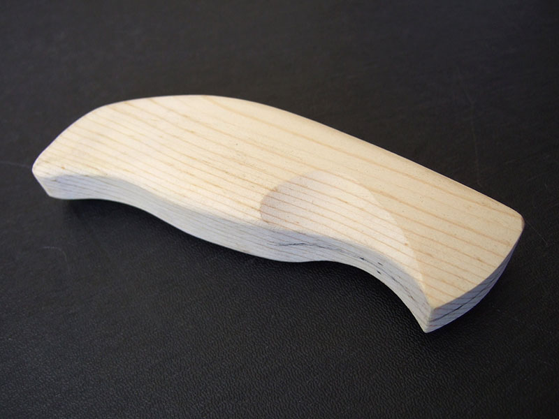

I used a $3 scrap wood 2x4, traced out the mule handle, and then mocked up a few solid wood handles, contouring them and making ergonomic adjustments on each one. After four prototypes (when making my first Mule), I ended up with a shape that fit my hand very well. Then I just shaped the real scales/mule handle to match my mockup. The solid wood mockups also allow me to try some crazy ideas for extremely cheap, as I don't use the final wood until I've developed something I like.

jabba359 wrote:I used a $3 scrap wood 2x4, traced out the mule handle, and then mocked up a few solid wood handles, contouring them and making ergonomic adjustments on each one. After four prototypes (when making my first Mule), I ended up with a shape that fit my hand very well. Then I just shaped the real scales/mule handle to match my mockup. The solid wood mockups also allow me to try some crazy ideas for extremely cheap, as I don't use the final wood until I've developed something I like.
Very nice. Lol, maybe I should have thought about doing trial runs. Oh well, too late for that now! I'm going to try to get some more work done today, if the wife permits me. She's got a to do list as long as my... Military. ;) Maybe some pics later.
