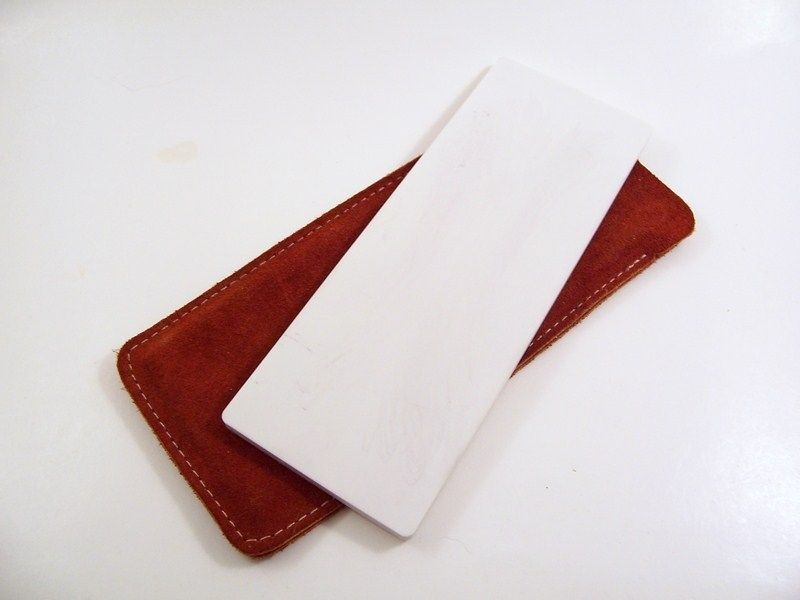

After putting it off for a while I finally decided to pick up the 306 Ultra Fine Benchstone. Up to this point my finishing stone has been a DMT EEF stone. I find that the 306 yields a nicer finish and a very keen edge. It does load up with metal after some use but is easy to clean with Barkeepers friend and I like the fact that I will never need to flatten it. All in all I have been very pleased with it. It will serve me well for a lifetime I believe.

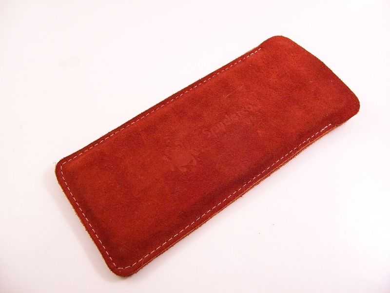

The 306 comes in a very nice suede case

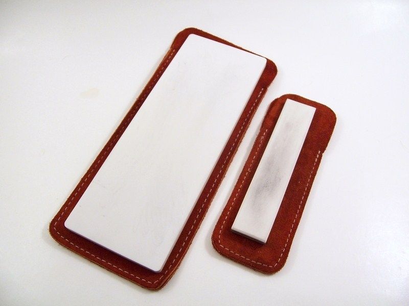

Here it is next to a double stuff stone.

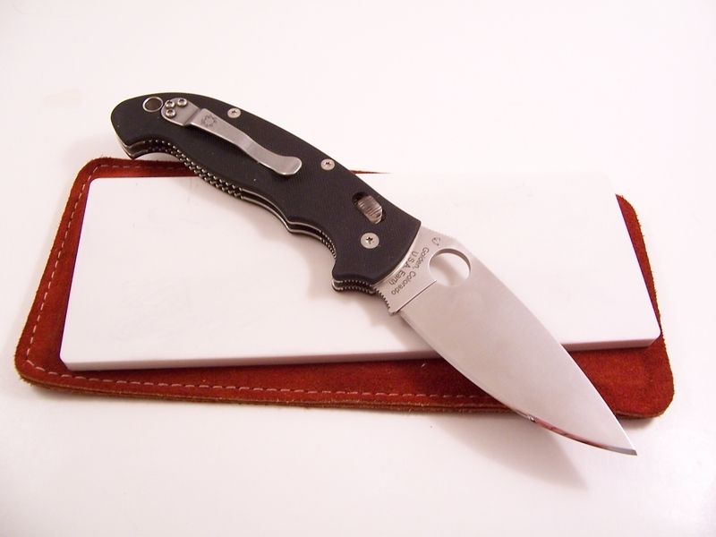

With a Manix2 XL.

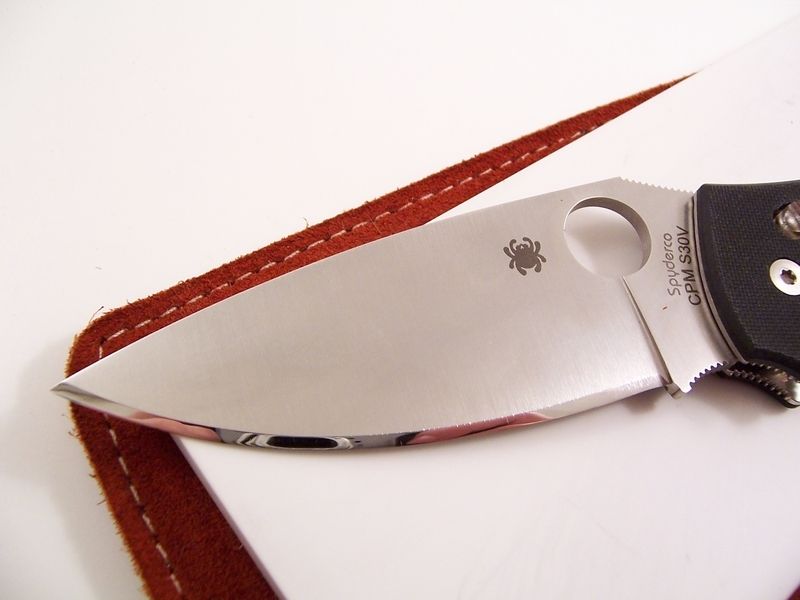

This is an edge achieved using the Spyderco medium, fine, and ultra fine stones followed by DMT diamond pastes at 6, 3, and 1 micron on leather strops.

I would say you got the sharpening thing down. Awesome work, not sure I could get that level of polish freehand.

That is a really beautiful edge.
