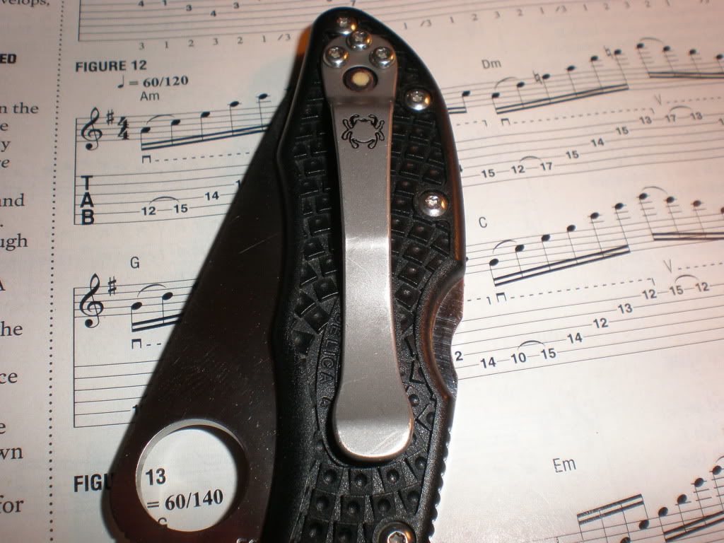

Drkknight614
- Posts: 438
- Joined: Sun Sep 04, 2011 12:12 pm
- Location: New York
The way I took the paint off was by using a dremel and those felt heads. I applied sharpening compound on the felt and went to work. It takes some time but it does work. I used green compound to clean it up. If you do it this way you need to be careful, bc the clip will heat up a lot and if your holding it you will get burned.
Manix 2 DLC, Delica 4 FFG, Ladybug 3,County Comm H1 Ladybug 3 , Endura 4 FFG G10, C94 UKPK Leaf, Atlantic Salt, Military Camo DLC,Sage 1 Para 2 DLC, Delica 4.

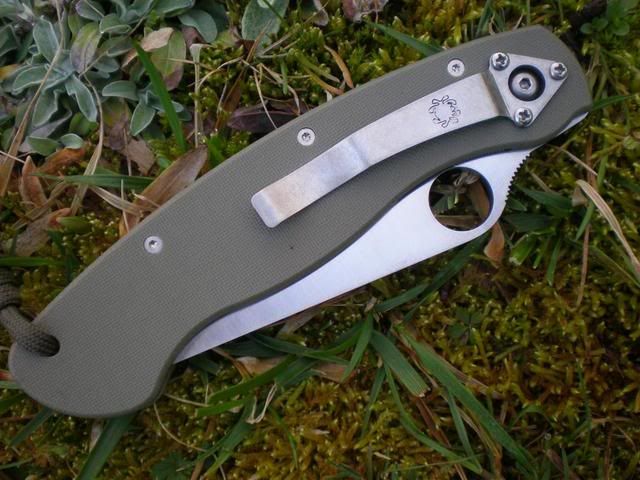

A possible alternative would be to contact Spyderco and find out whether they have any of the unpainted clips from the red G-10 Sprint Run Persian on hand and would sell you one.
Paul

Deacon, am I looking at the wrong picture? What clip are you talking about?
