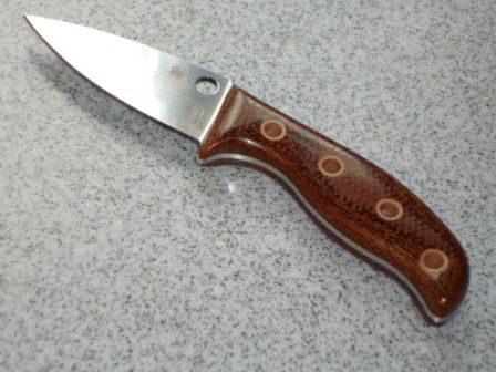

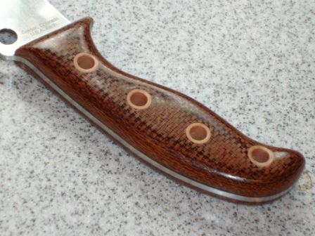

Here's my Cruwear Mule, wearing scales of barbwire micarta and micarta tubes. I started the shaping with 60 grit sanding drums and sandpaper and progressed to 2000 grit, them buffing wheels going from black, brown, red, and white compounds. This barbwire micarta is great stuff. I like it!

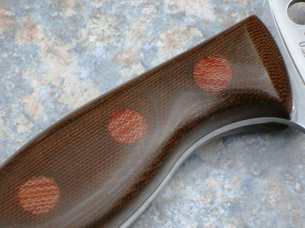

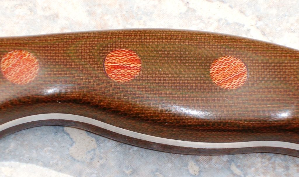

Here's my new Elmax Mule. The scales are green micarta, with some gray layers I've never noticed in green micarta before. The pins are 3/8" micarta. I started with 100 grit paper and went to 2000, then buffed with black, brown, red, and white compounds, using a Dremel tool.

Doug - that is some nice work! I really like the micarta caps over the pins. It gives the knife a whole new look.
I've seen those gray layers on some runs of canvas micarta. I think that since the canvas material is so rough and thick, that these are the thin lines of resin between the layers of cotton material. The micarta makers add a colorant to the resin to turn it green or black, and in some cases it cures a slightly different color than the material absorbed into the cotton canvas. I actually like it when it does this...

Thanks for the good words! Actually, the brown micarta isn't caps, they're pins that run all the way through. The large holes in the Mule are big enough 3/8" rods. I might do another one later using micarta rods in some of the smaller holes (3/16", I think). We'll see how well the epoxy holds it all together. I just need to get a couple of good sheaths for two of them now.
