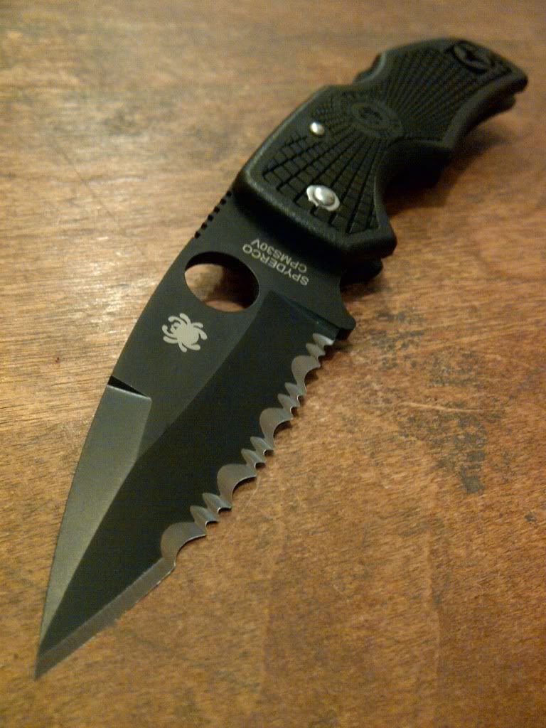

I can't say much. I just got my first black Spyder last week.. Image
I have cut plastic straps, wood, and some cardboard with it.
I haven't seen any affect on the DLC coating.
I wish I had it longer so I Had more to tell you.
I'm very happy with it
and very little help. :)
