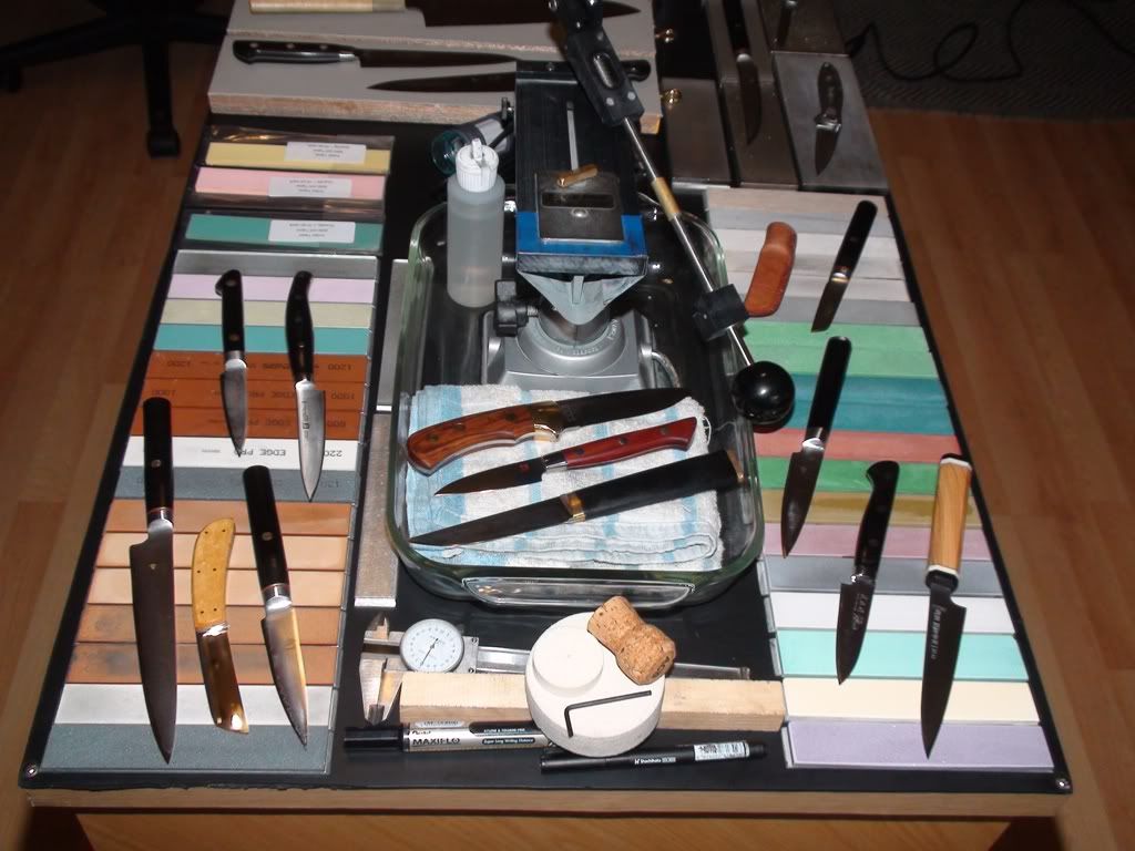

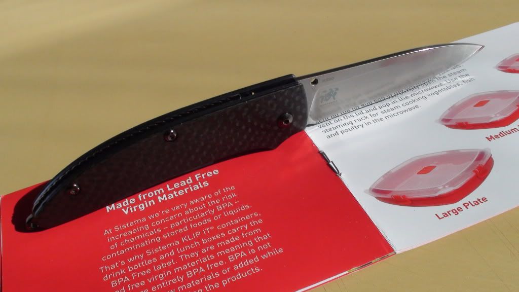

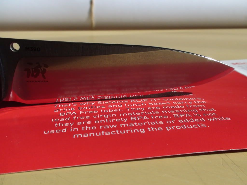

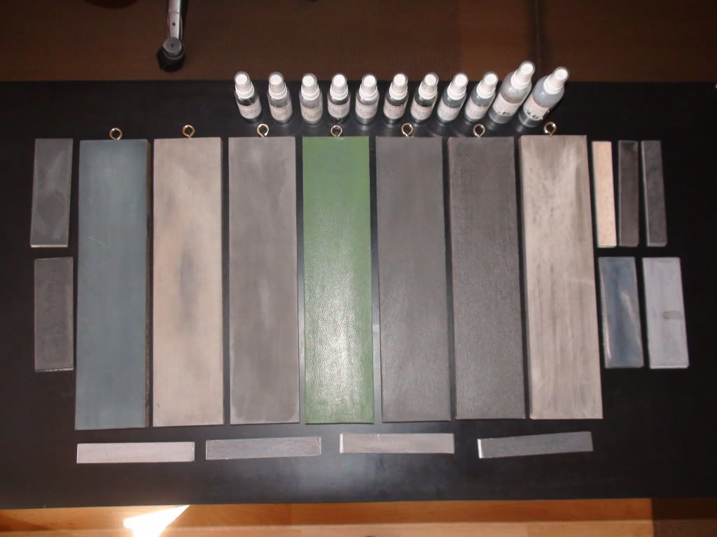

MadRookie
Posts: 784
My Setup
Post by MadRookie »
I do most folders at 15* (per side) relief with 20* (per side) micro bevel.
This one however sees lighter work and is M390 with 15* relief & 17* micro bevel.....
My sharpening setup.....
