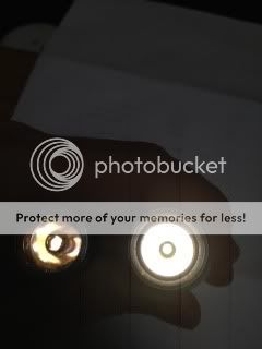

Logan left (2700-3000k? High CRI) Vs Zebralight SC51w (4200k neutral led). Cool White is 6,000-6,500 typicically. Perspective is off, hotspot is similar in size

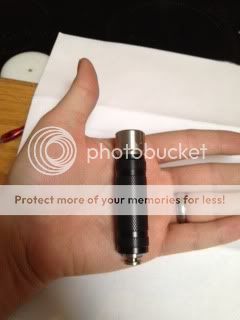

QTC Operation is very simple. Twisting slowly clockwise ramps the XPG from almost a glowing match head to max brightness. With the momentary button a squeeze does the same thing. You can also go from moonlight brightness twisted to max brightness with the button squeeze, releasing returns it back to low brightness (or approximately).

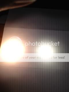

Logan left, Zebralight right (at a blistering .18 lumens :p )

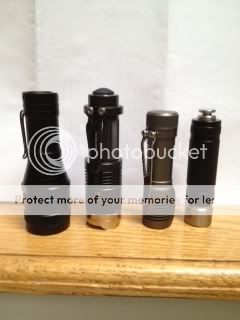

Comparison in size: Dereelight C2H/Javelin Hybrid (p60), Nitecore Extreme, Zebralight SC51w, Peak Logan 123 with momentary switch

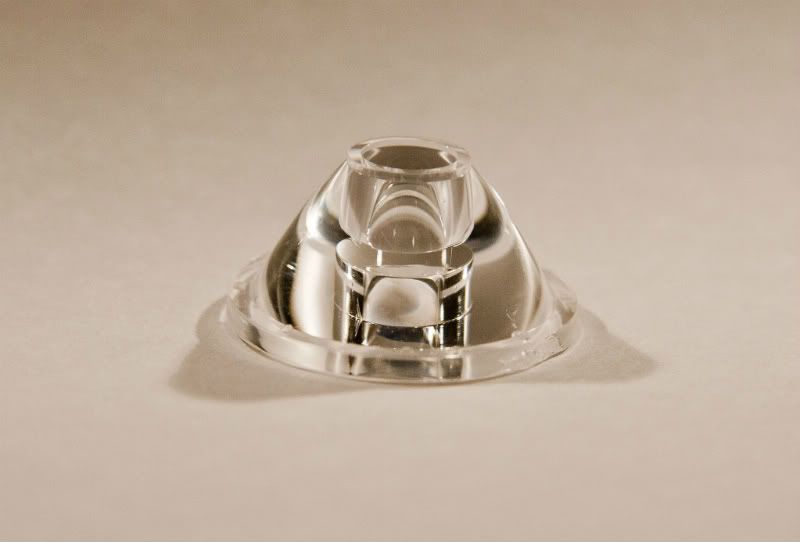

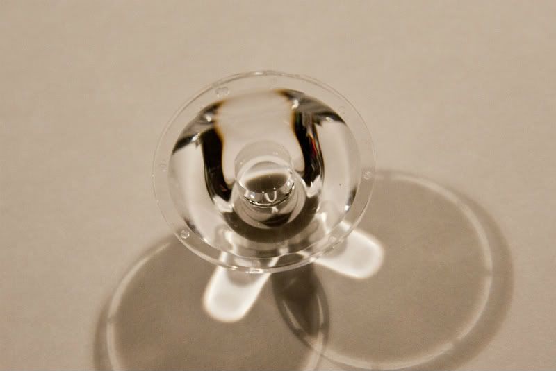

angusW wrote:The pics on their web site make it look like it has an aspherical lens. Does it? I don't see the option to turn it into a floody or did they just take that option away when they sold out. It states it does 300lm, using the cw led, but where does it say it's otf lumens?
Hey Angus, judging by what I'm seeing in the picture below this is similar to what Surefire is putting in most of their LED lights, also Gene Malkoff used these on his older drop-ins. It is a TIR Optic, I can't remember if it stands for Total Internal Reflector or something else. What I do remember is that it reflects around 85% of the emitted light out the front, they are very efficient. Not always the nicest looking beam, but it works well.
If you look at the side of one of these "reflectors" you can see right through it, it works on the principal like light reflecting off of water, if you have a low enough angle, it will reflect and not go through. That is why they are shaped like a parabola, to make sure the angle of the light hitting it is very low and that it doesn't escape the optic.
