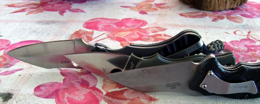

I came into posession of a Kershaw assisted open folder for the weekend. Not being familiar with this brand and not knowing the price it sells for precludes me from badmouthing it. As a matter of fact it has a few features I enjoy when compared with the PPT.
A mechanic I work with owns it and he has been putting in 60+ hours a week lately as the factory is woefully understaffed. This buddy appreciates the edges I get on my :spyder: 's and has lamented (between the lines) that he doesn't have the time to get his Kershaw very sharp like mine are. He owns some :spyder: 's and considers them to be in the same class as Benchmade which is why he doesn't put them through the abusive environment at work.
His edge on the Kershaw was in need of serious repair, so yesterday I asked him to let me sharpen his knife. I gave him the very sharp SG Delica to use over the weekend.
The Kershaw has a very nice hollow grind, an extremely positive blade angle and a really nice stout fat clip :) The time it took to take out the very deep chips in the edge tell me that it's good blade steel. For me the PPT is in a different class with the FFG and S30V, but the Kershaw is no slouch :)
Which leads me to Forum appreciation. 2 years ago I couldn't get a butter knife sharp :eek: After hanging around here, learning about edge angles, materials, and practicing I've been able to take this beat up edge and make it sharp. This wouldn't have been possible without the positive interaction I've enjoyed on the Forum. ZDP is still a PITA, but most other materials seem pretty easy now :)
Reprofiling of the Kershaw is done at a conservative angle considering the use it has had, now all that remains is setting a nice 40 deg microbevel and stropping. It will be a true pleasure presenting my friend a knife with a better than new edge.
I thank Spyderco and Forum members for setting the sharpness standard and maintaining the Forum. Being able to take a damaged edge and make it better than new is incredibly rewarding :D I would encourage anyone to do the same. No matter what the style it's the edge that really counts :D
PS. A Loupe is instrumental for the final result, during the Xcoarse stage I was able to tell exactly when the chips had been removed :)

A good look at the edge with a 15X lighted loupe before sharpening told me what I needed to do :)
The 40 deg bevel has been set on the Kershaw. Even if I didn't strop it I know the owner would be pleased. I will give it a little stropping just for giggles even though I know the extremely sharp edge will soon disappear.
It is very satifying to have the ability to make things sharp :) Thank you Sal for your encouragement :)

I'll reply a couple of more times to this thread if only for the learning I've experienced. The blade steel in the Kershaw is Sandvik 13C26. A very repectable material that is used for some razor blades.
My intuition was right when I gave the blade a good tough edge angle and a very sharp 40 deg microbevel :D This steel polishes well.
The owner of the Kershaw said that I have sharper knives than anyone else at the factory. Yet I am only a novice here among some folks that are much more capable and skilled. I can only learn and improve my knowledge and capability over time.
This has been my modest weekend project and I believe it was time and thought well spent :)
Keep 'em sharp folks :D

Sorry a little off-topic and I don't mean to hijack, but what's that Spyderco between the PPT and Kershaw?dbcad wrote:Couldn't agree with the tag line more. Being able to keep these knives sharp was a goal I had when I first started buying themIn this the tag line is very relevant. Sharpness is a never ending curve never quite hitting the ultimate.
Yes the knife in the middle is the leaf Urban. An absolutely delightful knife and my most carried.

I gave the Kershaw 1820 back today and my buddy was happy yet cautious at the same time. He said that he needed to treat the edge with much more respect, but that it will be used :) I think I gave him an edge he was not used to :D He did say also that the SG delica held it's edge very well.ChapmanPreferred wrote:Some folks who actually understand what it is to have a sharp knife are nearly giddy when I hand their knife back to them after an edge restoration or even a simple sharpening.
It's really good that Kershaw and other companies are paying more attention to materials while keeping the cost low :)
The main point of the thread was finding the ability to make good materials very sharp and being able to give that to another individual so maybe they can also develop the same appreciation that I have been able to develop through the Forum. As well it's about appreciation for this Forum and what so many of you have shown me over the past couple of years :)
Every blade I reprofile now is better than the last :D Sharpening is all about learning and enjoying what you're doing. Being able to share that with someone is incredibly rewarding :)
