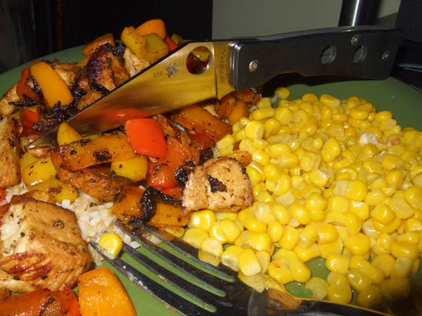

The super thin grind along with the splinter-picker tip. My Chokwe hadn't really cut anything yet (I've had it for a few months), so I decided to give it some food prep use today. I cut up some peppers and chicken to make some stir fry and it sliced like a champ. Here's the proof!
Stir Fry.jpg (86.79 KiB) Viewed 2302 times
