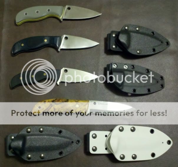

Yes, it's not a difficult thing to do. Just to get you started, think about how you want to deploy the knife. When you figure out the orientation, you can start experimenting. As for the clip, it will make the sheath a bit bulkier as bigger eyelets are used to accommodate removable clips.
You need:
- Kydex - 2 thicknesses are available, I like thicker .093 inch ones.
- A press - 2 or 3 layers of exercise mat taped to a pair of 2x4 pieces work. Some large C-clamps for pressure and it's good to go.
- Heat source - a heat gun and/or toaster oven at 300f for 10 mins
- Eyelets and tools (that match the kydex thickness)
- Electric Drill
- G-Clips + hardware - sold by Spyderco via phone
- Sandpaper / files for shaping and such
As for retention, you can "tune" the location of the eyelets to make things very tight or loose. By making 2 of the eyelets exactly an inch apart from the center of the hole, you made a mounting points for the clip.
There are good video how-to's on youtube. Check em out. Here are some of mine:
Ones at the top and bottom are the latest, best designs. The middle one is not symmetrical or well designed. :)
