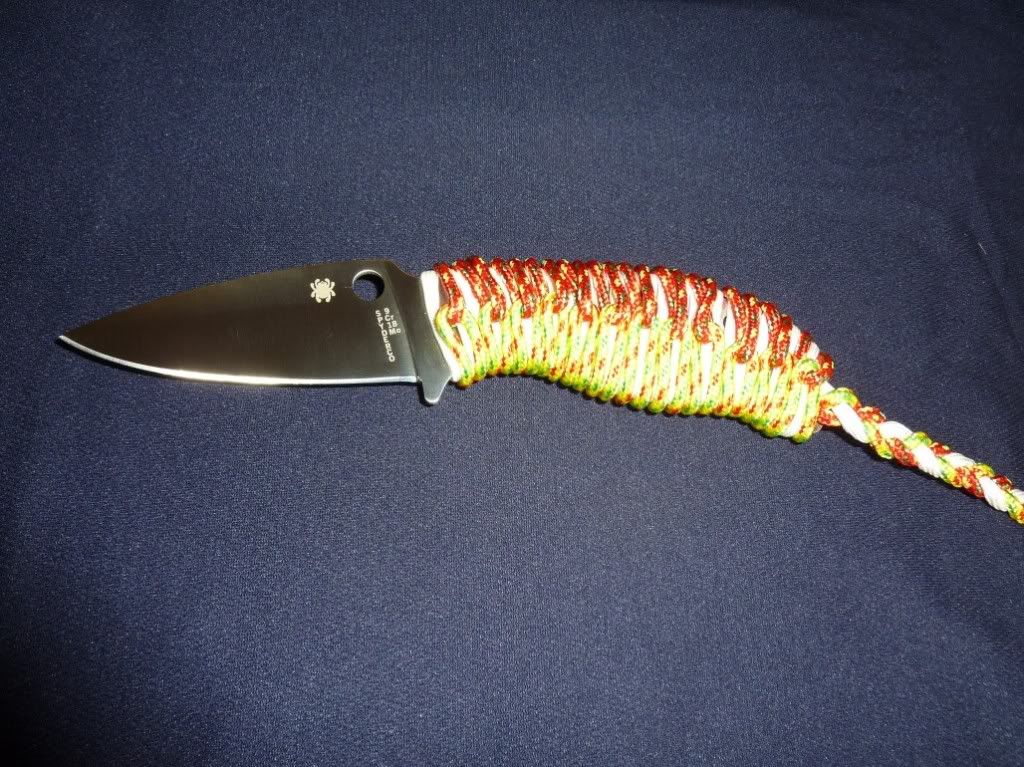

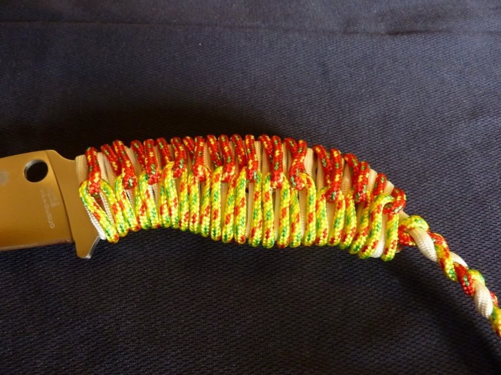

Well, I tried that style of wrap. I first used some white paracord for an underwrap, then added two diff colors of accessory cord for the 'strider-style' wrap. Here is the result.
It's not quite as straight and neat as I'd like, but it sure does provide a solid, hand-filling grip.
Any and all comments / criticisms welcome. :D
Kento
