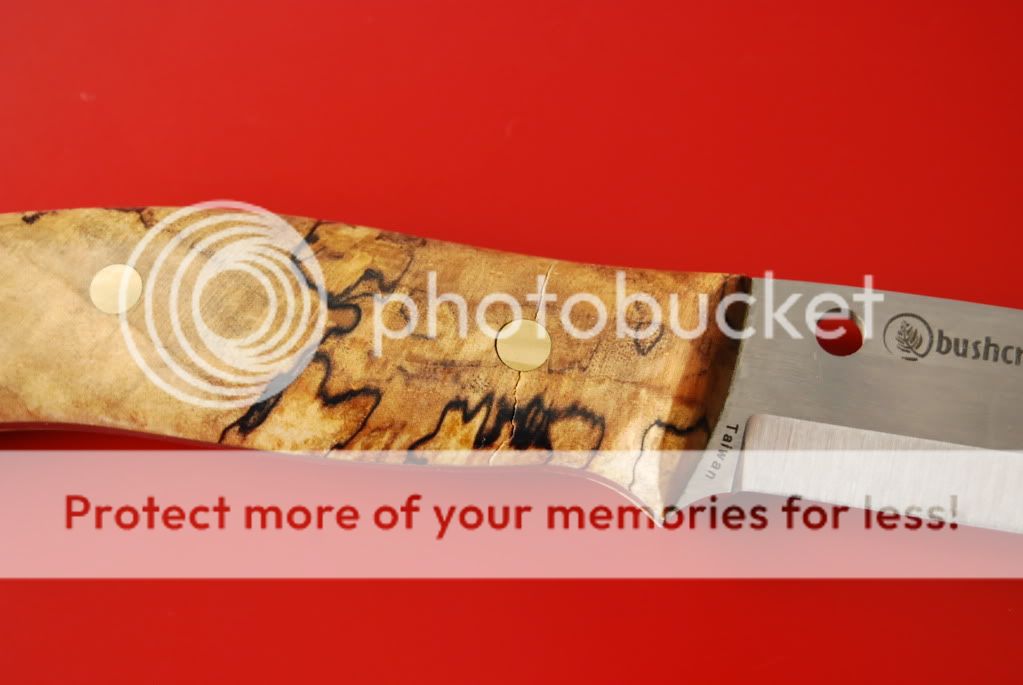

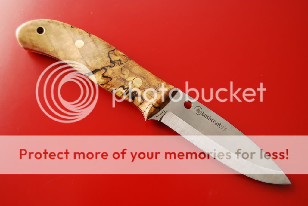

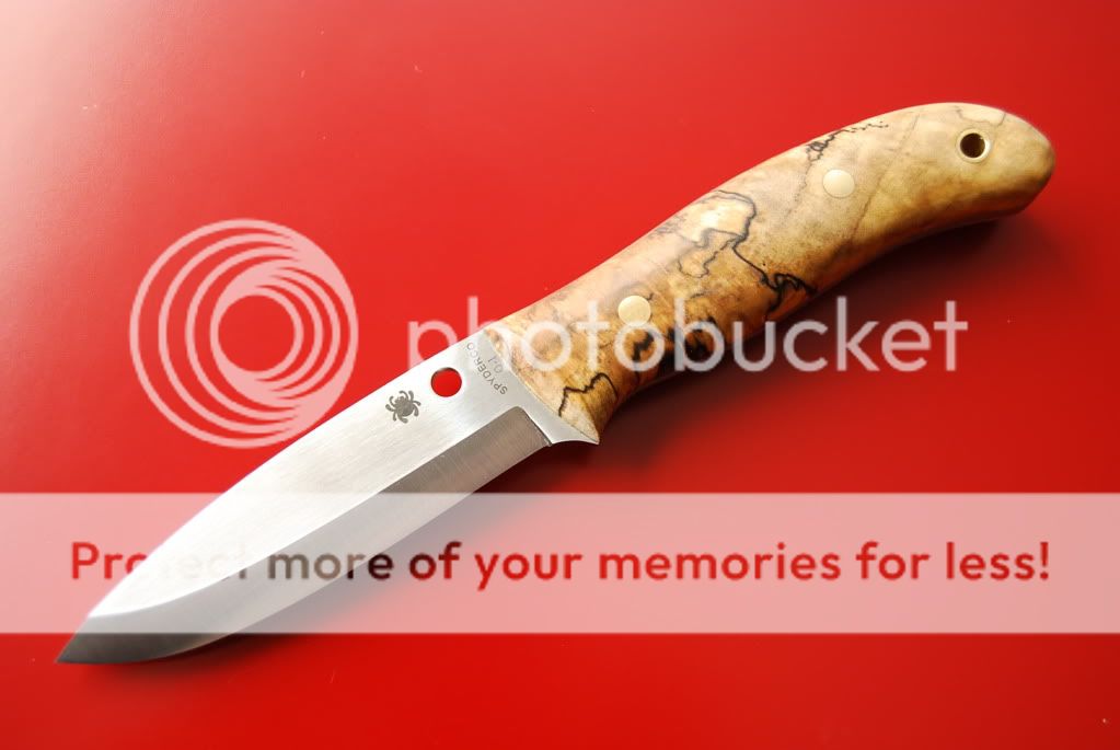

I received my Bushcraft 2nd yesterday, and despite the expected imperfections in the wooden handle, it’s a very impressive piece. My knife has 3 visible cracks (two somewhat significant, one very minor), but the spalted wood is quite lovely (sorry, no pics…my camera is currently loaned out). I can’t see how the cracks will compromise the functionality of the knife, but I probably would have been a tad disappointed if I had found them in a “first quality” knife. Despite my lack of mechanical skills, I’ve taken the advice posted here and purchased some rubber-toughened (black) low-viscosity CA to try and fill the cracks; I’ll give it a shot once the wood has had a chance to acclimate to its new environment.
What impresses me the most about this knife is the incredible ergonomics of the handle. Too many of the fixed blades I’ve handled recently have relatively thin, flat handle slabs. While this may enhance the concealability and portability of these knives, I’ve never found those types of handles to be comfortable, particularly for extended use. The Bushcraft’s curves fill the handle nicely and provide a very stable grip. I hadn’t paid too much attention to this knife when it was first announced (I’m not an outdoorsman, and I wasn’t at all familiar with the bushcraft movement), but I can see this knife becoming one of my favorite blades...I’ve always been a fan of knives made with traditional organic materials, and I’m really appreciating the opportunity to use a Spyderco with a wooden handle and a (very well-made) leather sheath. If the wood stabilization issues can be resolved, I would love to see Spyderco make another run of this design.
I have one minor nit, and it pertains to the blade rather than the handle. The first inch or so of the blade has several small irregularities; it looks/feels like a combination of a slightly jagged edge and a rolled burr. I’m not sure it could be accurately described as chipped; it almost looks as if that portion of the edge had an unplanned encounter with a nail or stone. I don’t know if this is a normal consequence of the Scandi grind, but it’s definitely not the polished edge I’m accustomed to on Spyderco products. The rough patch can probably be smoothed out in short order (although I’m not familiar with proper sharpening protocols for Scandi grinds). I realize that the knife is, after all, a “second” and that imperfection are to be expected, but I was a bit surprised by these issues with the edge.
That being said, I’m still very impressed with this design…I would definitely like to see more Spyderco knives in this vein.

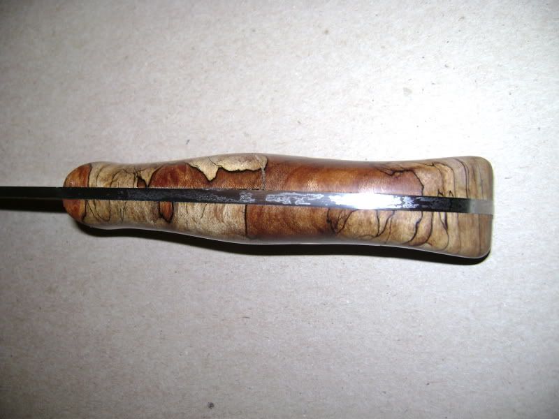

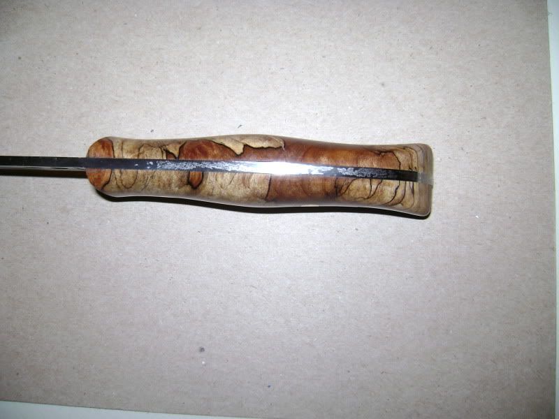

Just took some pics of mine, here ya go.
The only crack on mine
Canis
Canis

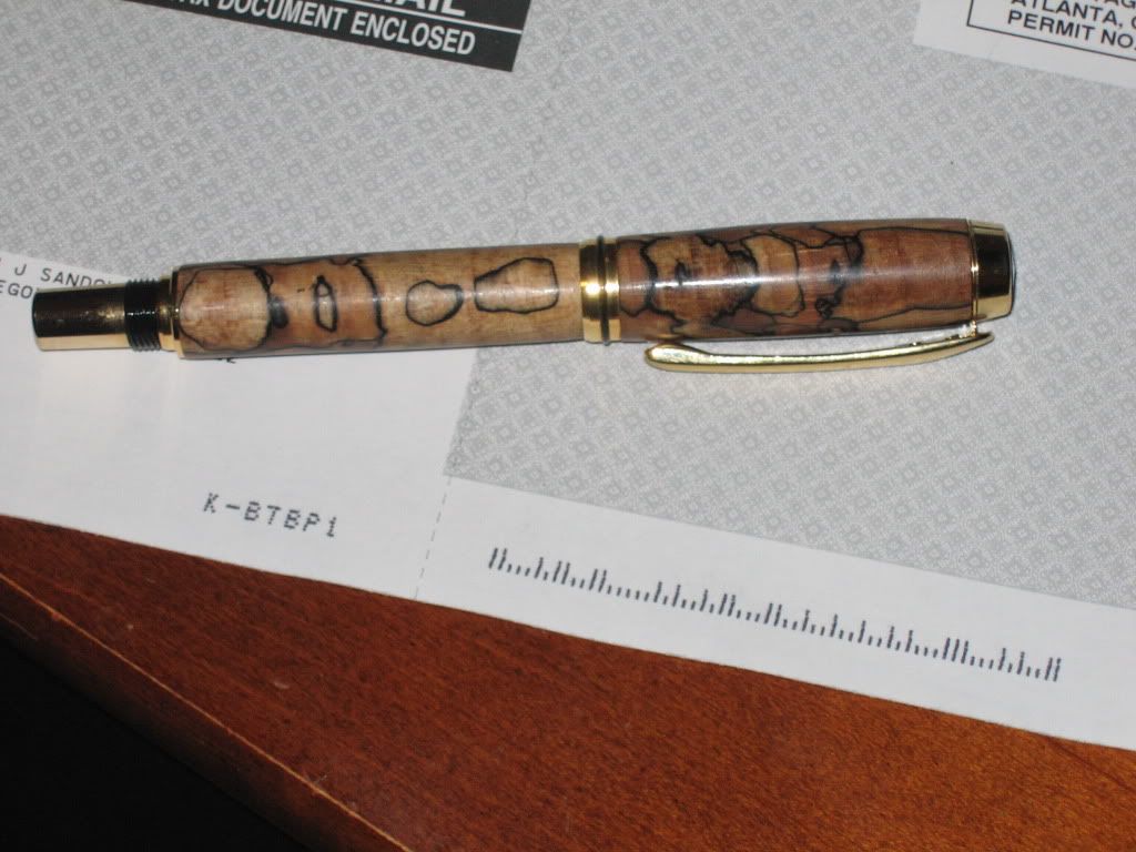

You are right about the stabilization process. If it is stabilized correctly, the wood is now an acrylic. The way the big boys do this, is in a big auto clave. They use resinol 88 that is fairly expensive, and they put the wood in an auto clave and pull 20Hg of vacuum on it. This puts the resinol into the cell walls of the wood, replacing the natural moisture found in the woods cell walls. The resinol dries, and it is like dipping a sponge in epoxy. You now have a totally different product. The product is also impervious to moisture, gas, fuel, kerosene, diesel, antifreeze. FYI if you have a vacuum pot and a way to pull 20hg of vacuum, you can do this at home. The only problem is , last time I looked resinol 88 is $256 a gallon :eek:yablanowitz wrote:Burl woods such as this spalted maple don't have a straight grain, at least not enough of it to make a difference which way it is cut. Properly stabilized burl woods are practically synthetics anyway. It appears to me that insufficient pressure was used during the resin impregnation stage of the stabilization process. The resin simply did not penetrate and seal the wood everywhere the way it should have. I have a stabilized burl Queen whittler in my pocket right now that was made in Titusville, PA and subsequently moved out here to the near-desert without a hint of cracking anywhere. I don't think the wood supplier knows what he is doing.
Here is a pen I turned from some Crosscut Spalted English Beech
In this picture you will see that the lines that run perpendicular to the pens (East/West) axis are not the grain, but the rings of the tree. the grain actually is point at you, and at the desk. (like the end of a log,when you split it) If you tried to turn a regular/non stabilized piece of wood on a lathe, oriented this way, it would explode on you, once you hit it with a cutting tool! I hope this all makes sense!

My second has this also. Kinda looks like it was used to try and cut a brick. My 1st has a perfect blade though, so I am not complaining.UglyJim wrote:.

Recieved my Bushcraft today. immediately noticed the 4 pretty good sized cracks and on examination found a fifth smaller one. This was expected. Pretty much like the other pics I've seen on this thread.
As I handle it further I'm amazed at how much a part of your hand this knife can be. It feels like an extension of me. The feel is superb! It is exceedingly beautiful as well! I have already ordered another one.
Now, to fix the cracks and get the scales back out to the tang:
1) Let it acclimate for a week or so.
2) fill the cracks with low viscosity rubberized CA, let it cure and sand (with dust mask).
3) repeat step 2 until the cracks are completely filled.
4) obtain some Tru Oil and wet sand using 000 steel wool (would 0000 steel wool work? Think so) as per Hector's advice.
5) use the knife during the time required for these steps. Being held and used might help it feel better :) :)
Please correct me on these steps for the handle If I've gotten anything wrong. All have been garnered from this thread, hopefully understood as intentioned. This'll be my first time attempting this kind of wood rehabilitation.
