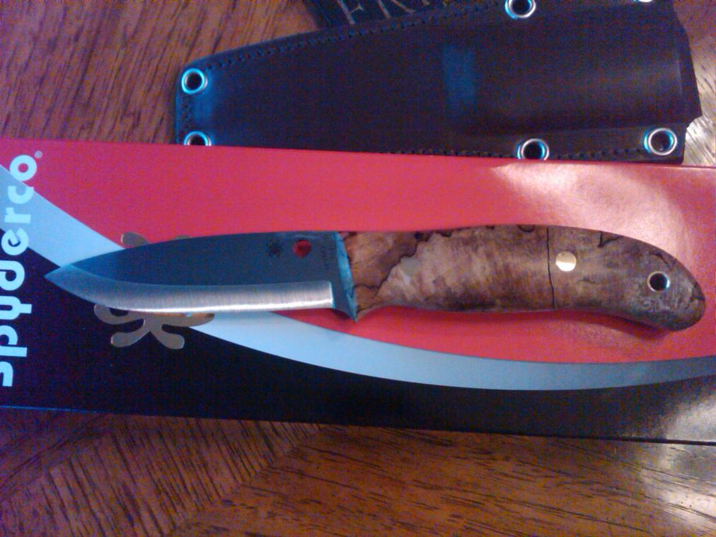

Just got mine today. Its got 3 cracks - one on left scale near rear pin and 2 on right scale on rear pin and btwn pin and handle end. Here is pic of the biggest crack (50% bigger than other side) on on left scale. Sorry for camera phone pic.
This is a hefty knife. I love the weight, beefy blade and the way the handle fills my hand. To be honest, I like this handle better than my Temp 2 handle in terms of feel. Havent really used either, so I can't comment on that yet.
Per the advice, Im going to wait a while to see what happens to the cracks while they get used to the southern california climate.

I have to ask the stupid question for my own education. Why wouldn't some type of wood filler work here? Isnt that what it's made for? :confused: I know it would not go deep down into the crack like a liquid CA glue, but it's made to fill cracks in wood and be sealed. I will follow the advice outlined in this thread, but just had to ask. :o

1. It will be a very shallow fill, unlike the CA, which will wick into the crack if you use the thinnest types, and will likely pop out as the wood expands and contracts with temp and humidity.Pneumothorax wrote:I have to ask the stupid question for my own education. Why wouldn't some type of wood filler work here? Isnt that what it's made for? :confused: I know it would not go deep down into the crack like a liquid CA glue, but it's made to fill cracks in wood and be sealed. I will follow the advice outlined in this thread, but just had to ask. :o
2. It will probably be more visible (due to its fixed color) than CA.
