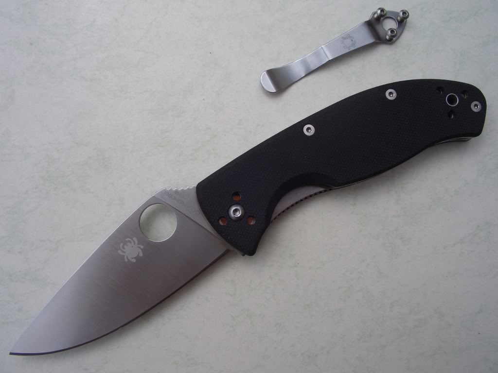

...completely for a thorough cleaning. As with most linerlocks, it is much easier to do so than with a lockback Spydie, especially the FRN Delica/Enduras :)
Anyway, when I saw the knife in parts on my table, I started counting of how much parts this knife actually consists.
Just for the heck of it and for those who didn't already broke down their Tenacious or a similar Spydie: how much parts, do you think, did I count?

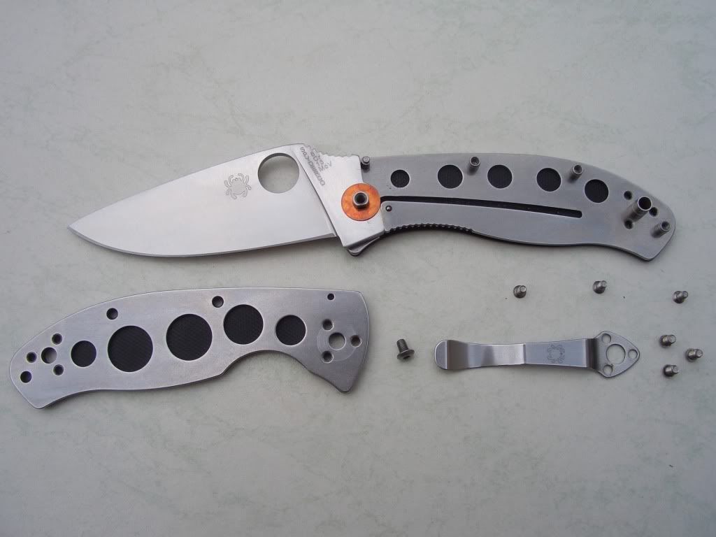

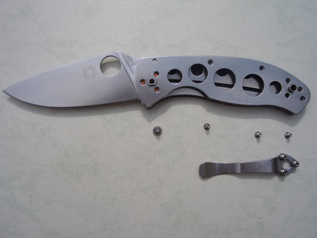

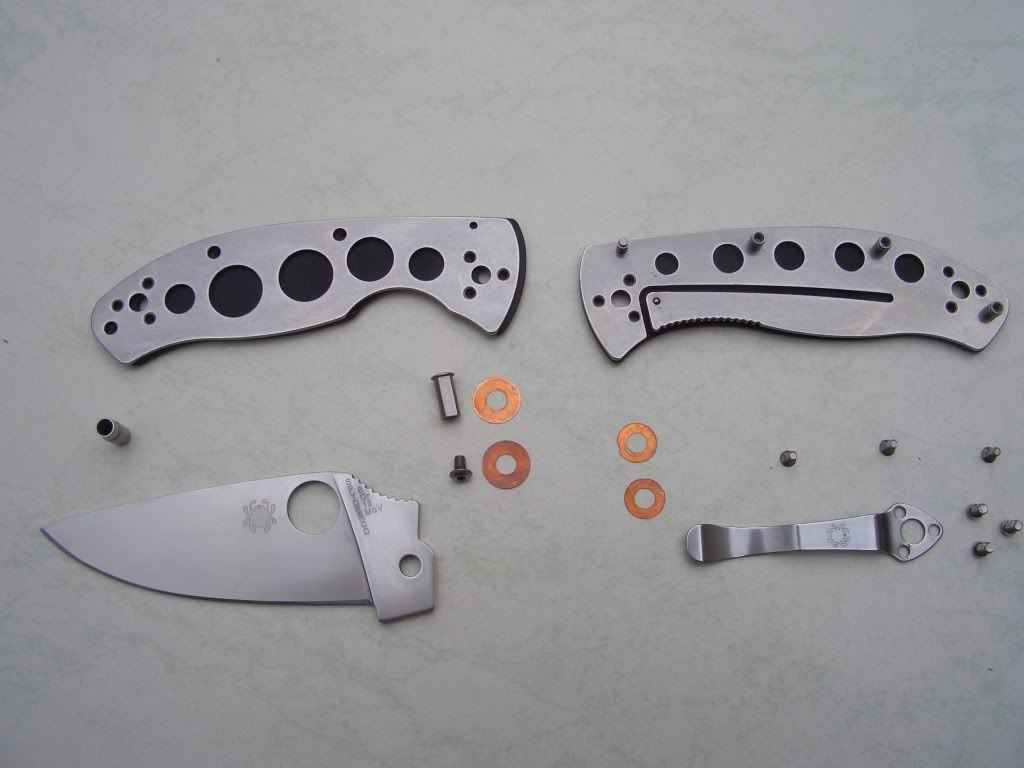

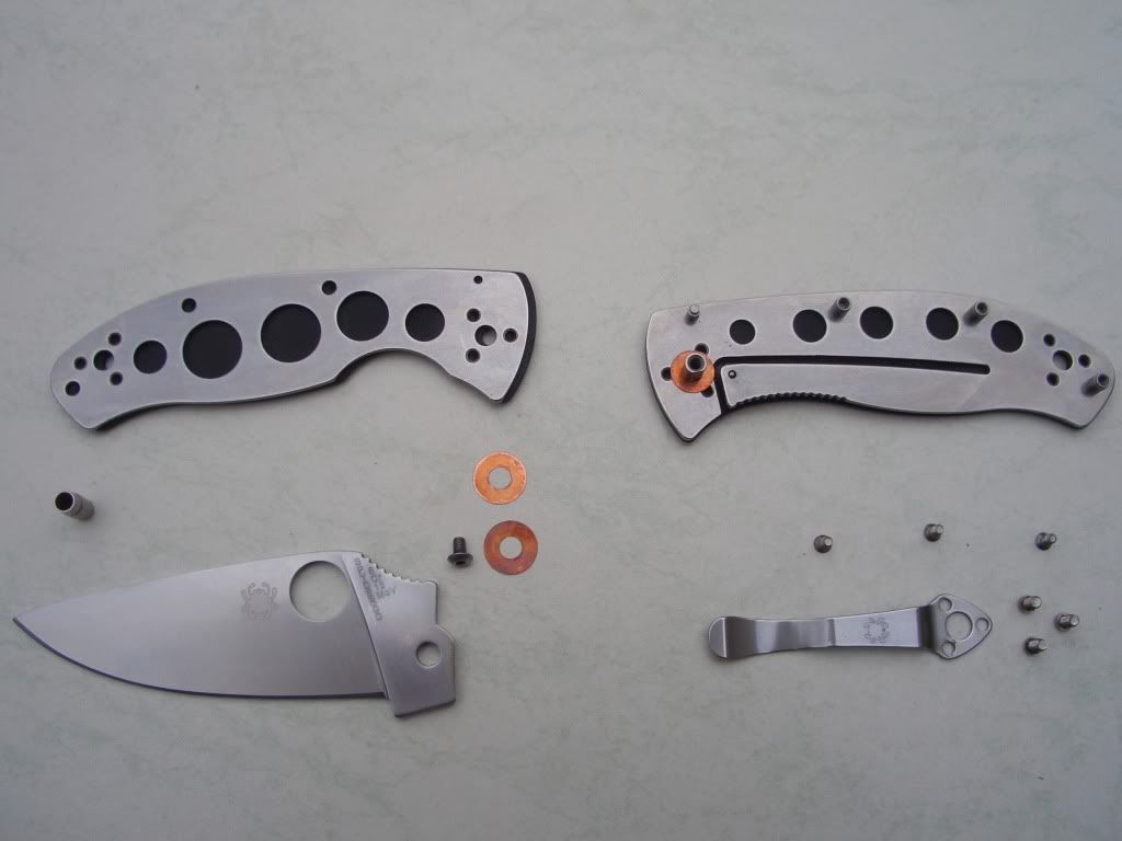

Oh yes, I did :)
here goes:

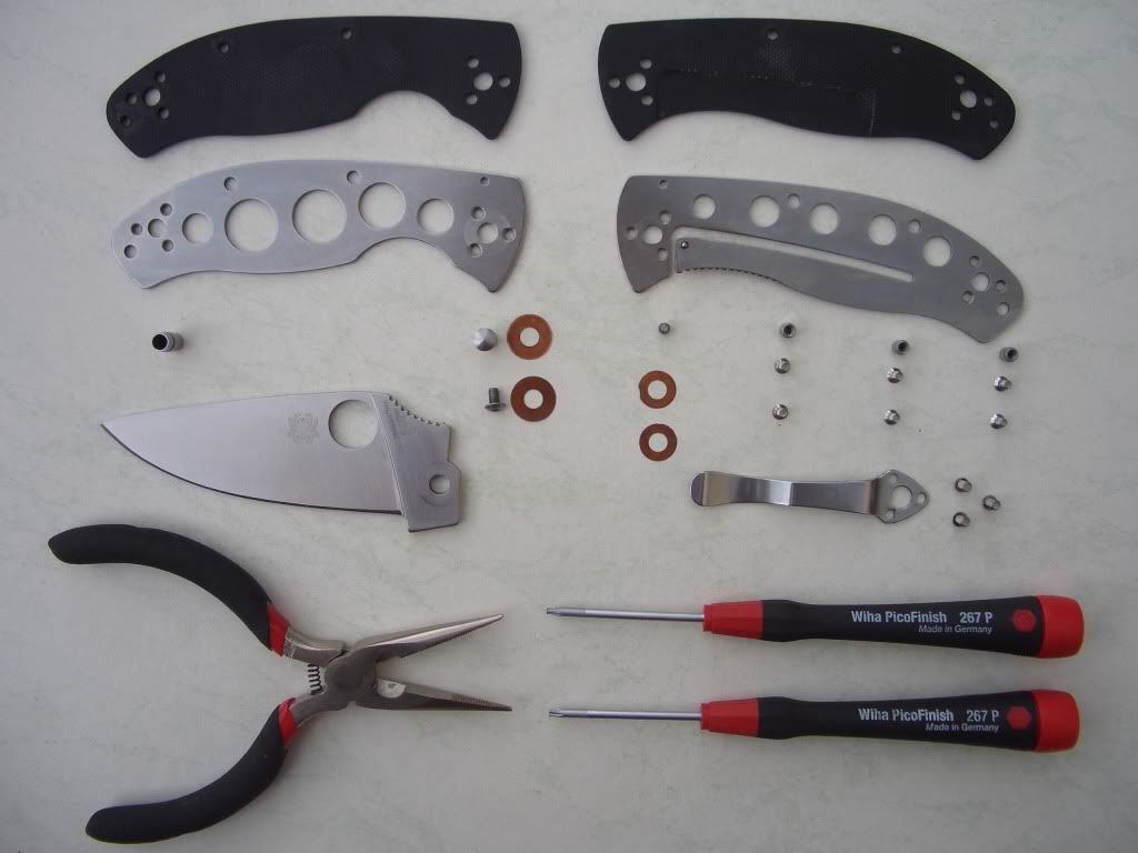

I added the tools I needed to disassemble the knife...
vampyrewolf is correct: As you can see, my Tenacious consists of exactly 26 parts! (I didn't count the detent ball as a seperate piece, Paul. If I did, you would of course have been spot on, but you are right anyway ;) )
More than I thought in the beginning, and that's why I asked in the first place. Most of you did, like me, underestimate the number of pieces needed to create that knife.
Regarding the washers, I think that the guy who finally assembles the knife can choose of different washer thickness and number of washers used to achieve the best fit and centering of the blade. In my case, the blade was centered quite well anyway, so he could use the same amount of washers on either side.

Ok, some proof I really used all of the pieces to reassemble the knife:

Something doesn't look right with those front washers. It looks like there's two different sizes of washers and maybe the small ones are supposed to go up front?
